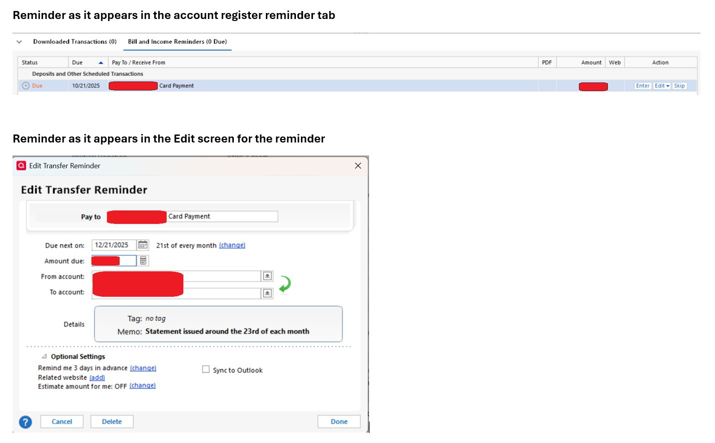

About a month ago reminders stopped working properly. Specifically, Reminders for some transactions wouldn't appropriately move to the next date after the transaction is entered. Instead as this screenshot shows, this is happening:
- In the Reminder views (e.g. at the bottom of the account register), the Reminder still shows up with the current date (e.g. 10/21 for this example)
- When I open the Reminder for edit, it frequently doesn't show the current date (10/21), nor the next date (11/21), but rather the following date (12/21)
- If I manually edit the Reminder to the correct next date (11/21) it properly adjusts in the reminder views for a bit… but then later goes back to the behavior above

- When you run your validation, does it come back with any errors or mention any damage? Just reran it. It says 'QEL: No read errors.' and 'QEL: All internal consistency checks passed.' It says '5 scheduled transactions corrected' but none of the 5 are the ones that have been giving problems with reminders
Also of note:
- When I first opened Quicken today, the reminders were all correctly in the future. But after I ran OneStepUpdate, some of the reminders came forward incorrectly
- I had deleted & recreated one of 4 similar reminders yesterday. After the OneStepUpdate, the 3 I didn't deleted incorrectly came forward, but the one I deleted/recreated didn't come forward. Based on that today I deleted / recreated the other three. I'll see if those stay 'correct' and also I'll keep deleting / recreating ones that have this issue. Maybe over time that will solve the problem.

As an update… It looks like manually deleting and recreating the individual reminders is working. I’ll just keep doing that as the “legacy reminders” run into issues.
Partly because of that, I’m not going to try to sort out Microsoft’s OneDrive setting. As Markus said Quicken itself uses it now. Beyond that, nothing changed with it in the last few months so I don’t see how that would have broken the legacy reminders.
