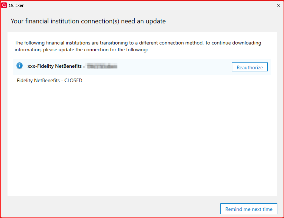

I migrated all of my Brokerage and Retirement account from DC to EWC+ last week and, except for not being able to properly manage FDRXX MMF as Cash instead of Shares in my IRA and Roth IRA accounts, for the most part it is working pretty well.
But every time I do OSU I get the popup prompting me to migrate a NetBenefits 401K account.
The problem is that this account at both Fidelity and in Quicken has been closed since 2015. So clicking on Reauthorize doesn't work because I no longer have any access to Fidelity Netbenefits. My login for that site has long ago expired and cannot be reset.
Using my Fidelity.com login also does not work because that login was never used with NetBenefits.
So, I end up having to close the browser webpage and waiting for Quicken to tell me that the reauthorization process failed before I can start to use my file, again.
Clicking on Remind me next time does close the popup so I can proceed with OSU. But every time I initiate OSU I get this reauthorization prompt, again.
I also confirmed with the Online Services tab for this NetBenefits account that it is not connected.
This prompt shows the FI is xxx-Fidelity NetBenefits but the General Tab of Account Details shows it is zzz-Fidelity NetBenefits. On the General tab I've removed this zzz-Fidelity NetBenefits from the FI line but when I close Account Details and reopen it the FI still shows zzz-Fidelity NetBenefits.
Is anyone else experiencing this?
Short of deleting the account (which I will not do), does anyone know how I can stop the migrate prompt from popping up?

    I had the same issue with a long ago closed Merrill Lynch account. Assuming you hid the closed Fidelity account, go to Accounts and tick Show hidden accounts. The account you closed will have Direct connect showing in the Transaction Download column when it should state "Not Available". So something in the version when we closed these accounts did not clear this correctly.
    What I did to resolve this was to create a new Offline account with a similar naming structure. Once created, I used the Move transactions menu option and selected all transactions from the "bad" account to the new account. The move process ran without issue and I briefly reviewed all looked OK in the new account.
    From there, I once again closed the new account and verified "Not Available" was present. I then successfully deleted the problem account and no longer get prompted to reauthorize.
    I failed to mention, but of course did a backup before starting.
    Good luck.

    @GeoffG - This morning I did the following which resolved the NetBenefit EWC+ migration prompt issue for me.:
    1. Created an Offline 401(k) account.
    2. Moved all transactions from the problematic NetBenefits account to the new Offline account and confirmed that this process was done correctly.
    3. Deleted the problematic Net Benefits account.
    4. Closed the Offline account.
    5. Initiated OSU which completed properly without prompting me to migrate the Offline account to EWC+.
    While the errant fractional shares issue was not a contributing cause to the issue I was experiencing your suggestion did help me to identify the errant fractional shares in the NetBenefits account, to identify the root cause of that shares issue as originating in the prior Hewitt 401(k) account (going back to the converted original MS Money history) and to get the issues resolved in both accounts.
    And your suggestion to set up the Offline account, move all the transactions from the errant Net Benefits account into this Offline account and then to delete the Net Benefits account fully resolved the errant EWC+ migration issue for me.
    So, thank you for your assistance on both matters.

    Interesting. I started the process with Accounts List and got this:
    • It shows the account is still connected with DC…but on the Online Services tab of Account Details it shows the account is not connected.
    • Last Download = Not Available. So this is correct and not as you saw with your situation.
    • FI: Shows xxx-Fidelity NetBenefits but on the General tab of Account Details it shows zzz-Fidelity NetBenefits.
    • The account was closed in Quicken in Jan 2016 (not in 2015 as I'd mentioned earlier)…so why does it show the last reconcile was 4/28/2017?
    Then I went to the Holdings view of the account which showed 3 securities with small fractional shares. So I did Update Share Balance to 0 shares for each of them. That resolved those errant holdings.
    Then I initiated OSU and I got the migration prompt for -my Fidelity.com login id. Not for either xxx-Fidelity NetBenefits nor zzz-Fidelity NetBenefits. So that certainly was weird.
    I decided to proceed with the reauthorization attempt and it logged me into Fidelity.com but this NetBenefits account was not included in the list of accounts so I could not authorize it.
    I'm getting tired. I think I'll try doing your suggestion to move the transactions to a new offline account, see if the transactions and holdings look correct. Then delete the main account and close the new offline account. I'm thinking that might work because then Quicken will no longer have a previously set up DC account to try to reauthorize. I'll let you know tomorrow.
    Quicken Classic Premier (US) Subscription: R65.15 on Windows 11 Home
