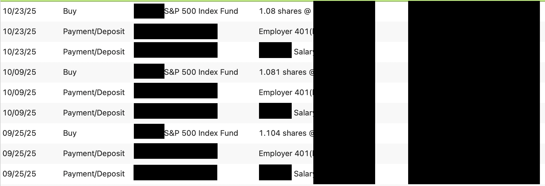

Both accounts are setup in Q as manual accounts and I created securities for my 401(k) holding.
The cash deposits are automatically entered as income every two weeks. The security purchases are manually entered to match exactly what my 401(k) provider, in my case Fidelity, shows.

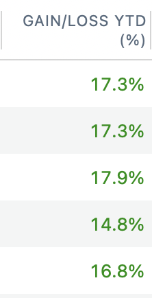

The transactions are all recorded on the same dates. The total return values that I’m looking at and referring to in this post are the values found at the bottom of the graph on the “Portfolio” tab when looking at the investment accounts.In this image the top two accounts have the exact same return YTD despite having different starting balances. They had no contributions this year. The second two accounts are my two 401(k) accounts which have had the same investment holding and the same contribution schedule all year.
@sneff30 , have a look at gain/loss (%). You can choose it through the second symbol in the top right corner of your portfolio tab.
Are the return numbers here different. What about cost basis and market value ?
The Gain/Loss (%) values are different as I would expect. These accounts are different ages and have old retirement accounts rolled into them. I only expect the return values for this year to be the same since they have had the exact same investment holdings the entire year.
What about cost basis and market value for YTD option ?
