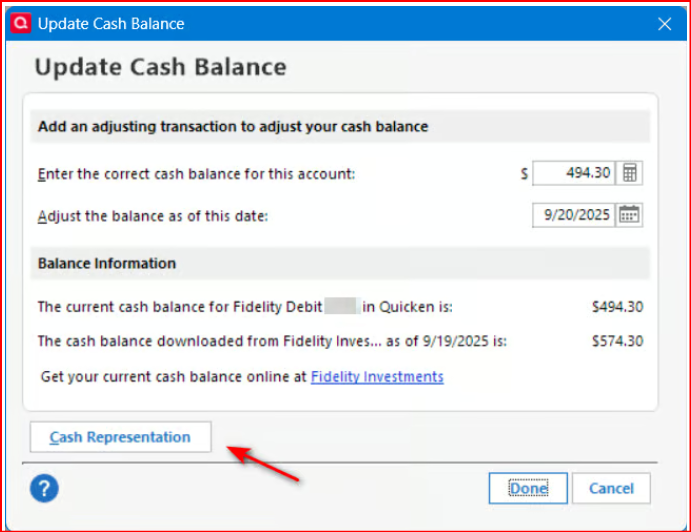

    • When you click on the Cash Balance at the below the Account Register toward the right: Does the amount reported by Fidelity look right or is it incorrect?
    In the Account Register: Click on the upper right Gear icon and then click on Update the Cash Balance. Do you see this Cash Representation button?

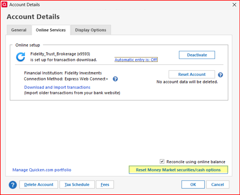

    Or on the Online Services tab of Account Details do you see this Reset Money Market securities/cash options button?:
    If so, click on it, close and then reopen Quicken and then run OSU, again. Did that resolve the issue for you? (Some have posted that it did resolve some or all of the issue for them but it did not for me.)
    What I have resorted to doing is to manually enter the missing FDRXX-related transactions and to, if necessary, make sure the Quicken amount in the Cash Balance then equals $0. It's not ideal but at least that will then get the Account Balance to match what is shown on the Positions tab of the online account at Fidelity.com. Hopefully the planned R65 version update will truly fix this issue so I don't have to do this anymore.
