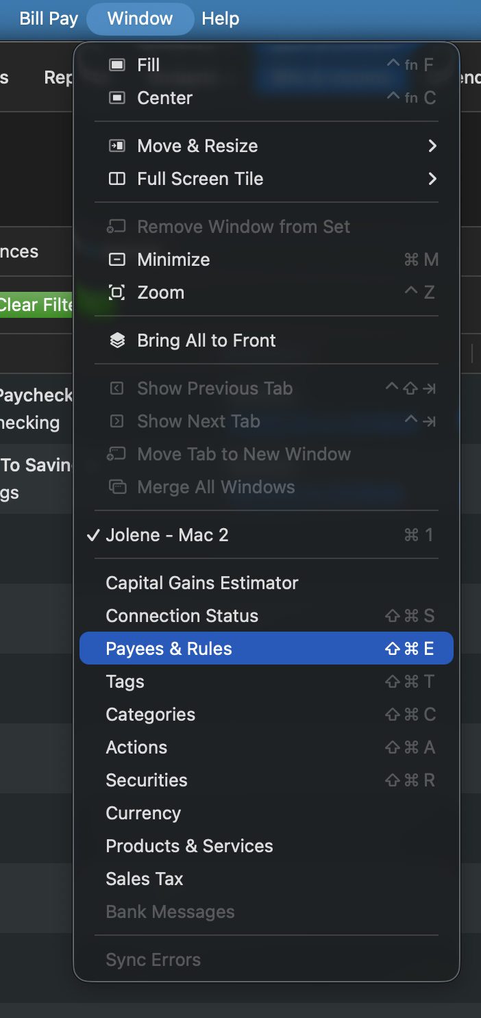

- Do you have any Renaming Rules for this payee?
- You can check by going to Window>Payees & Rules. Then look for the affected payee.

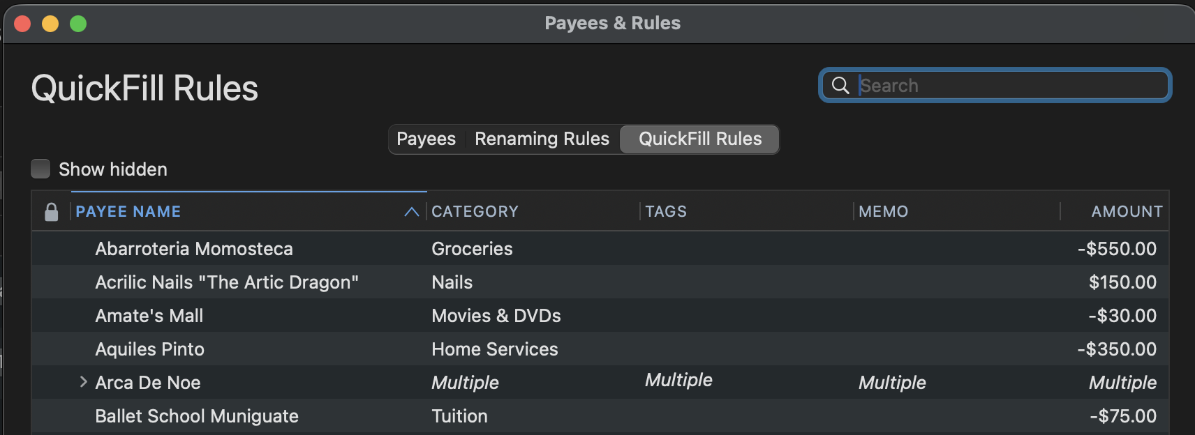

- Do you have any QuickFill Rules for this payee?
- You can check this by going to Window>Payees & Rules>QuickFill Rules. Look for the affected payee.
If you do have rules for this payee, I would delete them and then see if these transactions still download without a memo.
