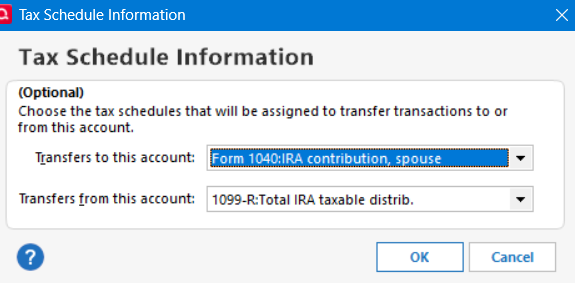

@Glen Raggio No, you do not have to remember. You need to edit ACCOUNT details for the IRA account, the Tax Schedule button.
Make the Transfers From selection as shown. Withdrawals from the IRA account to a taxable account will show up as income in Tax planner and tax schedule reports. That is how the tax line assignment gets made. It is not through a transaction category. In an Income/Expense report, it will show up in the income section as a transfer from the IRA account.
