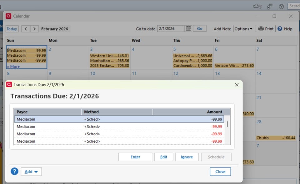

On one particular bill reminder has duplicated itself at least 100-fold. Appears to have started about a month ago. I am running Quicken Windows subscription and I have not had a problem like this before.

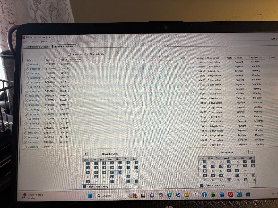

Hello again,
I am having the same problem. See screen shot. It has happened on multiple reminders. To fix it I have to delete the reminder and recreate it. After I fix one another comes up (different reminder). I thought it have something to do with Sync function so I disabled Sync but it is still happening. I am using Quicken Classic Deluxe Version R65.29 Build 27.1.65.29. I am running on a PC with Windows 11.

My Quicken file is stored on my local drive.
It seems like this started sometime in the last couple of months.
No special updates, just the normal Quicken updates. I don't recall any Windows updates but there may have been one.
I currently have three showing up in my calendar at the moment in June, November, and December. They are all for annual bill reminders although there have been monthly reminders duplicated in the past.

I can try this but every time I delete one that is duplicated and reenter it, I find another reminder that is duplicated that wasn't before. I can't get to a place where there are no duplicated reminders. Fixing one just creates others.
@ciduncan Thank you for clarifying that.
In this case, please do not continue deleting and recreating the reminders, since that is clearly not stopping the duplication cycle.
At this point, I recommend going straight to validation (and Super Validate if needed) without attempting to clean up the reminders first. Once that’s done, please let me know whether the duplicates stop appearing.
The validation cleaned up the duplicates. I will watch to see if any reoccur.

I had the same issue with certain reminders being duplicated in the calendar view. I'm running Quicken Classic Deluxe with data stored locally, but I do sync with the cloud. Performing the Validate that Anja recommended fixed the issue. The text file that was generated by Quicken Validate confirmed the fixed items and also prompted me to fix a few old items in the register, which was pretty easy. I did not need to do a Super Validate nor stop and restart the cloud sync like I have seen as a possible fix elsewhere. Overall it was a pretty simple fix. Thank you Anja!
