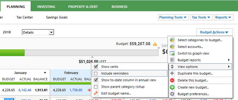

I am using Quicken in Windows and did a budget for 2026 - can I set the "actual amounts" to zero until I actually incur and record the expense? It says they will show as incurred but my 2026 budget is full of "actual amounts" Thank you.
You can tell the Budgets view to not include future reminders:
Click Budget Actions / View options and uncheck "Include reminders". This way, your future months' Actual will be 0.00 until you start recording actual register transactions or reminders into the future month.
