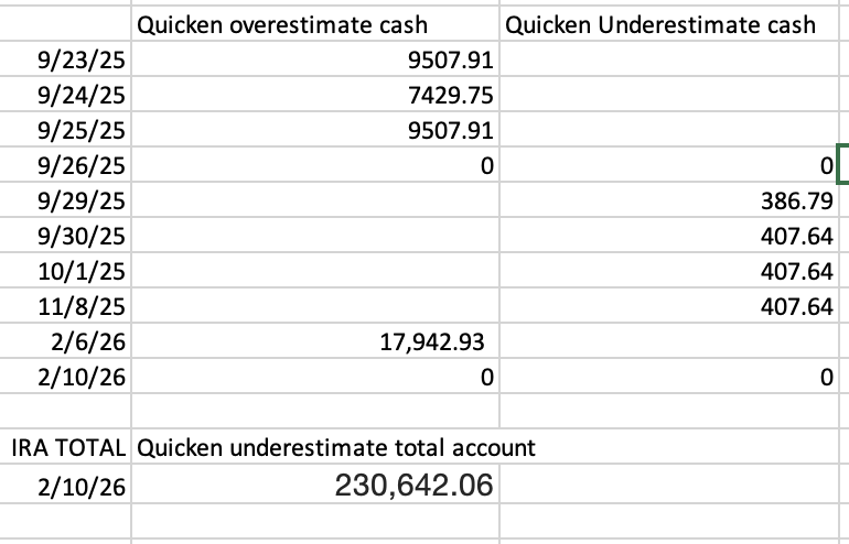

Quicken overestimated my IRA cash balance today by 17942.93. The last time I looked closely at this was 11/8/25, when Quicken was short 407.62 due to cash (a long time problem). Today, Quicken is overestimating cash by 17942.93. Quicken Portfolio tab has the 78,036.16 in FDRXX and the 17,942.93 listed as cash, but that second amount is not in Fidelity
11/8/25
2/6/26
Account total quicken short
407.64
Fidelity Cash Balance
17805.09
78,036.16 (FDRXX)
Quicken Cash Balance
17397.45
95979.09
Difference
407.64
-17942.93 (Cash in Quicken)

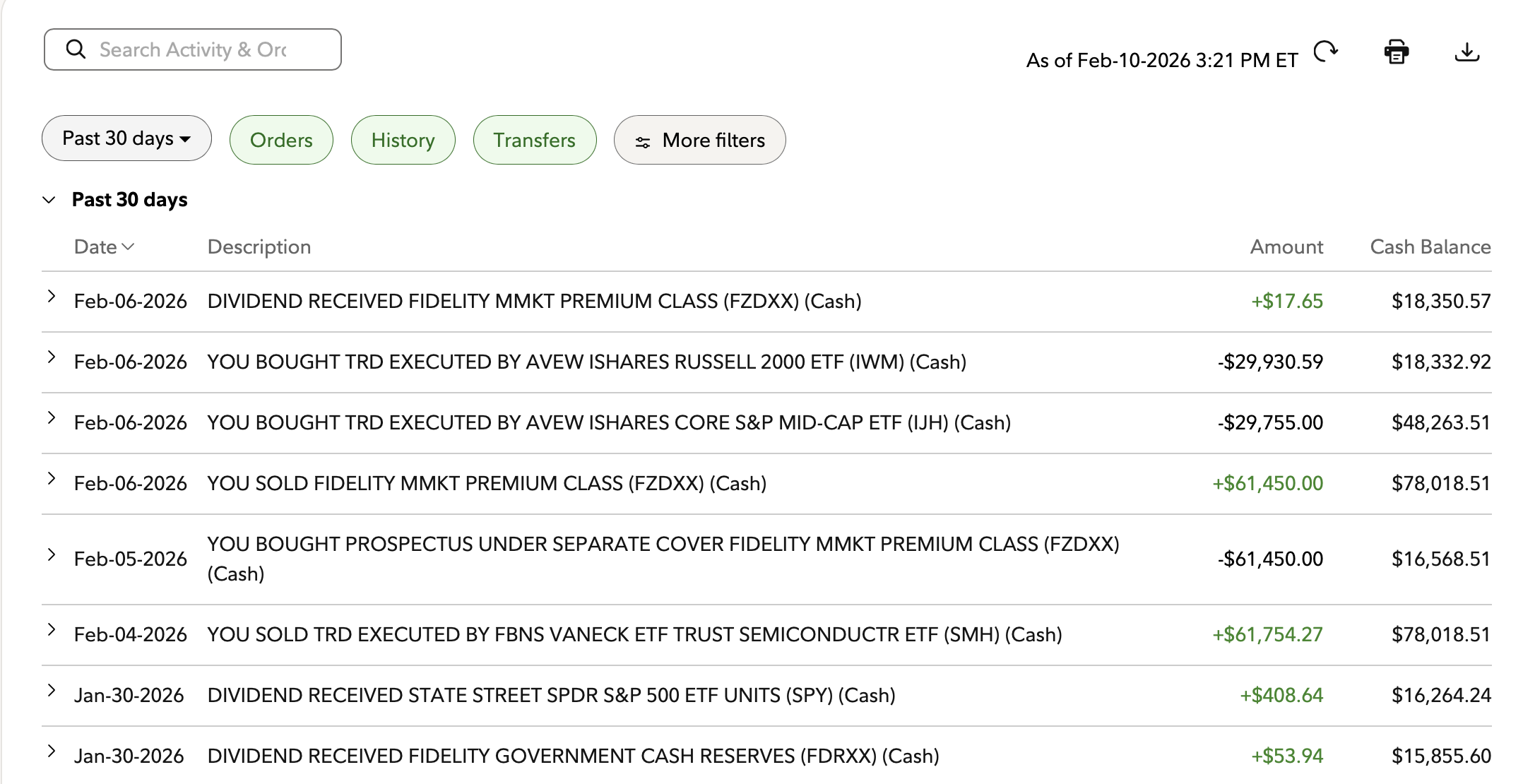

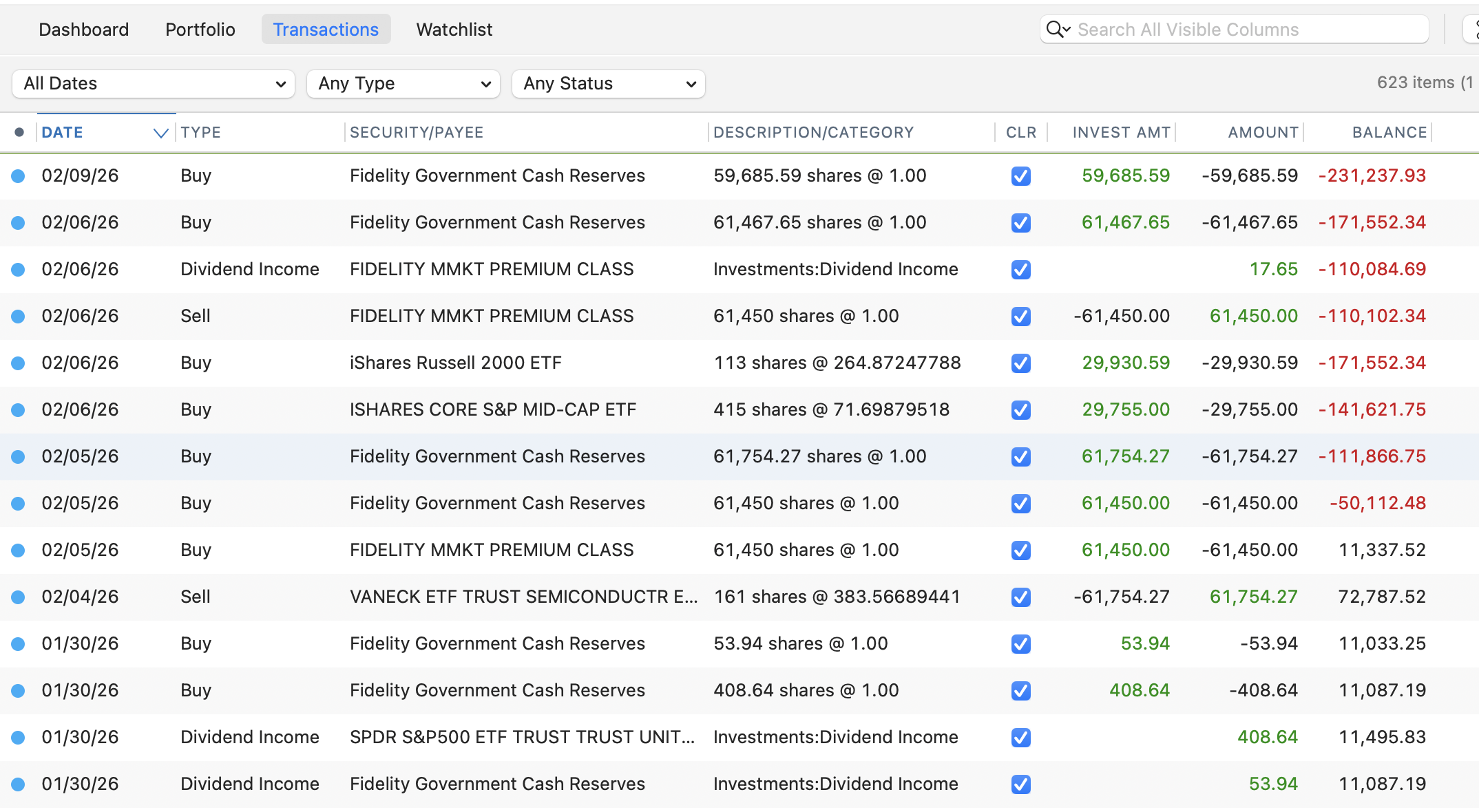

    1 - I don't know when it started, I started to try and find out where the imbalance was coming from back on 9/23/25. Today the cash amounts are in balance, but now the total amount of the ira is off by $-230,642.06 in quicken.
    When I look at portfolio holdings in both quicken and fidelity 2 ETFs are showing losses in quicken today that aren't in fidelity: XLK -37,588.80 and XLY -20,988.72
    Recent transactions in quicken that don't show in Fidelity
    Quicken transactions
    fidelity transactions
    Hope you can make sense of this but I can't. How can the quicken transactions show as CLR when they aren't in fidelity?

    Typically, for a transaction to show as cleared in Quicken, it would either need to download from the financial institution, or you would need to manually mark it as cleared. Did these transactions appear after you updated your accounts? Are these transactions the reason your account value is so far off?
  • daverph
    daverph Quicken Mac Subscription Member ✭✭
    As of today, quicken shows my cash balance in the IRA as -231237.93. There were 4 cleared transactions in Quicken for BUY FDRXX totaling 244,357.51 were not in Fidelity, two dated 2/5, 1 dated 2/6, and 1 dated 2/9. I never cleared any transactions manually. These transactions appeared after syncing if that's what you mean by updating my accounts.
    I went into those quicken transactions and zeroed the amounts and shares. I looked back into January's quicken transactions and found 4 more BUY FDRXX totaling 4823.35 that were not in fidelity and zeroed them out as well. Now the total IRA balance is short in quicken by 428.90, and the cash portion of the portfolio in quicken is 407.64 less than what shows in fidelity FDRXX, which is where it was back in November. It would be nice if it everything balanced but there are only so many hours in a day.
