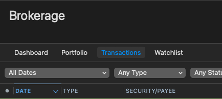

    If you prefer simple tracking, you can view the transactions tab. You would hold down the Option key and click on the Transactions tab. This will display the transactions until you navigate away.
    If you would like to troubleshoot the issues you are seeing with Detailed tracking, could you provide screenshots of what you see in Quicken versus what you see on the bank's website? If needed, please refer to this Community FAQ for instructions on how to attach a screenshot. Alternatively, you can also drag and drop screenshots to your response if you are not given the option to add attachments.
