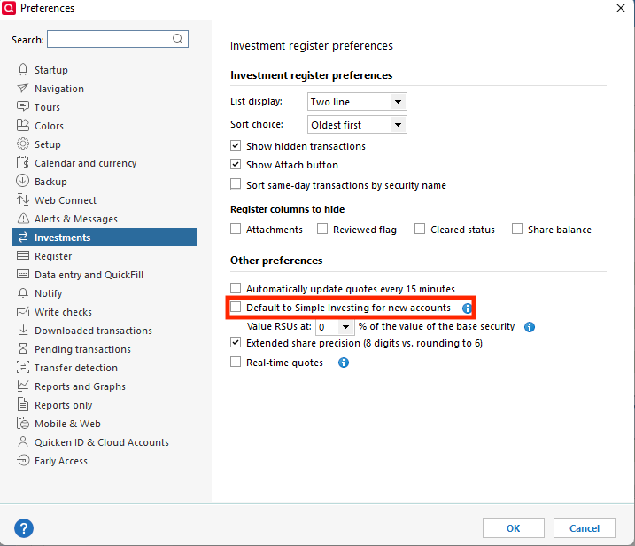

Thank you for coming to the Community with this question. Based on your description of the issue, it sounds like your Preferences are set to default to Simple Investing. To change this, navigate to Edit>Preferences>Investments. Uncheck Default to Simple Investing for new accounts, then click OK.
Once you've unselected that option, your Quicken should no longer default to Simple Investing when you add/reconnect your investment accounts.

It is not a "new" account. Regardless, my preferences for new accounts are not set to Simple.

This is also an issue for me and the proposed fix under "Preferences:Investment" was already set correctly. Ever since Vanguard started working again recently, when I re-establish my connection, it returns to "Simple"

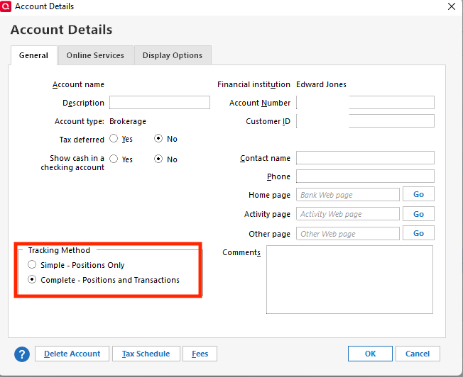

If you are connected via Direct Connect and it's still defaulting to Simple, try switching to Complete by navigating to Tools>Account List, click the Edit button next to the problem account, then, on the General tab, click the radio button next to Complete and click OK.

I changed the tracking method to Complete as you illustrated. I then reactivated the online services which changed the account back to the Simple method. Here is the message from Quicken:

@arlingpj I think the key to your issue is when you say
In some cases deactivating and reactivating via "Set up now" does not resolve the problem you describe; you must go through the "Add account" process and relink the problem accounts. Also for old Vanguard accounts you must specify the old account number that was used before the outage. Please follow this process exactly as described, no shortcuts!

- Go to Edit > Preferences > Investments and make sure the "Default to Simple investing for new accounts" box is not checked.

- Go to the General tab and now you should be able to select Complete mode. Select that.
