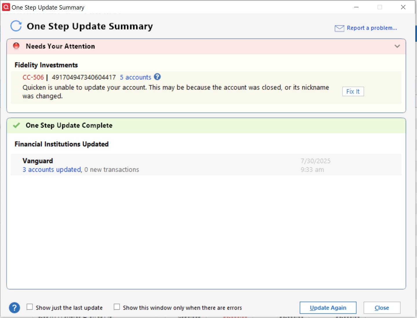

Unfortunately, I went through the migration to EWC+ on 7/29. Initially, the pain was relinking the accounts in Quicken. Then yesterday, the NAV's for my 401k did not update. I kept checking until almost 10pm Pacific time. The NAV's for my investment and retirement accounts did update. Then this morning I get a strange CC-506 error and this displayed:
Notice the strange huge number after the error number. This is unacceptable and needs to be fixed ASAP!
Update: I just checked and the NAV's for the 401k did update sometime this morning during my multiple attempts to resolve this error.
Update: I'm seeing this error in the CONNLOG.TXT file now also:
==== Mini-OSU Start (20250731/08:51:44) ====
20250731 08:52:08: Parse error. Current object: SECINFO Missing Tag: TAG UNKNOWN==== Mini-OSU End (20250731/08:52:12) ====
Frustrating that Quicken does not provide enough information to determine which account/fund has the problem, such as the object referenced in the error message!

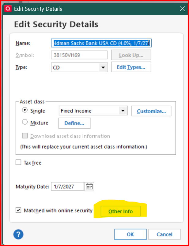

How do you turn off price updates for an individual CD / security? I'm having the same problem with CD's in my Fidelity IRA where each is being valued 100x lower than it should be. Thanks!

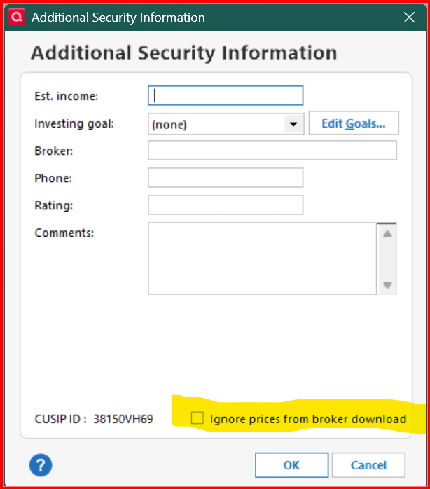

@gourmatt you can turn off price updates for individual CDs by going to your Security List and right click the CD and select "Edit". Then you should see an "Edit Security Details" settings window -
At the bottom of the settings window, click on "Other Info". Then check "Ignore prices from broker download"
When they resolve the pricing issue, remember to uncheck this option, so to resume pricing.

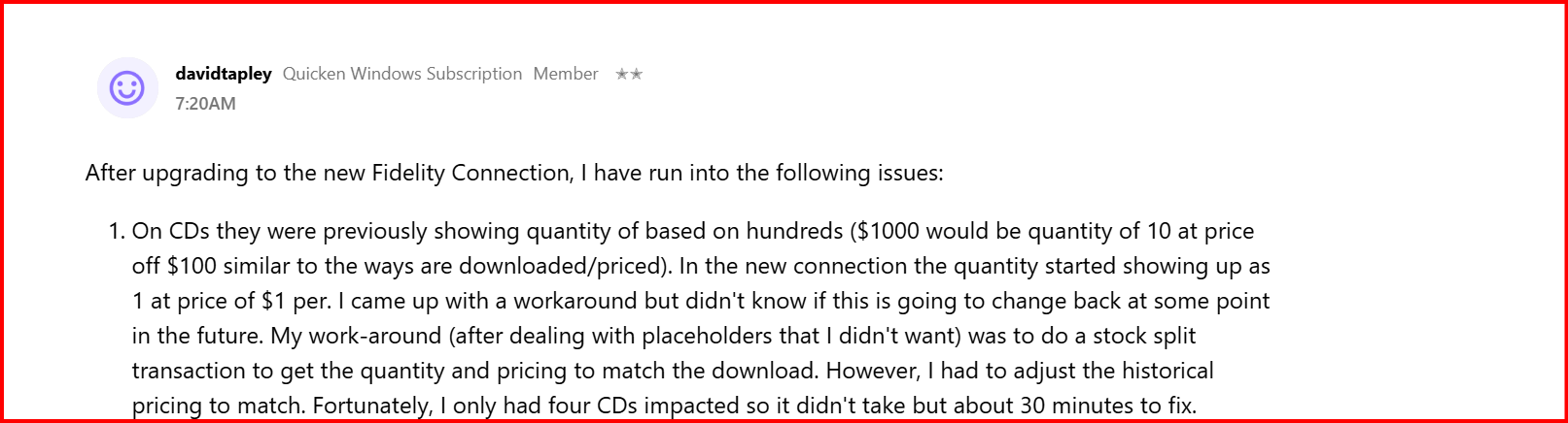

After upgrading to the new Fidelity Connection, I have run into the following issues:
- On CDs they were previously showing quantity of based on hundreds ($1000 would be quantity of 10 at price off $100 similar to the ways are downloaded/priced). In the new connection the quantity started showing up as 1 at price of $1 per. I came up with a workaround but didn't know if this is going to change back at some point in the future. My work-around (after dealing with placeholders that I didn't want) was to do a stock split transaction to get the quantity and pricing to match the download. However, I had to adjust the historical pricing to match. Fortunately, I only had four CDs impacted so it didn't take but about 30 minutes to fix.
- For the Fidelity Money Market Account, when downloading the month-end interest on 8/1, Quicken tried to treat it as a ReinvDiv transaction which created issues with placeholders. I basically had to delete the transactions and enter them manually. I double checked that I had not checked the Never interpret downloaded Money Market funds as cash in Edit/Preferences/Downloaded transactions. Is this going to be an ongoing issue or will the Money Market Funds act like they used to and just download as a Div and not a ReinvDiv (with Placeholder implications/disasters)?
- The most significant issue that I am having is on ReinvDiv transactions, the number of shares are rounding to the hundredth and not the thousandth like previously handled. I am having to manually adjust each downloaded ReinvDiv transaction to get the proper number of shares. Is there a way to get the rounding to be handled correctly?
