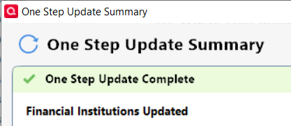

Same thing again today. Nothing on the OSU, but "Reset Account" brings in the transactions. Gimme a break, Quicken.

I remain in the same state I have been since August 20th. I can only get transactions to load in my Cash Management account if I "Reset Account." (It may have also missed one cash transaction 2 days ago, but I'm not sure.) That's been mentioned so many times in this thread (and I have also said so directly to Quicken support) that surely someone in Quicken could weigh in on why that helps when a "normal" OSU comes back with nothing.
I'll end this post with a pragmatic question: does anyone know the precise series of steps that should compel EWC+ connections to re-download all transactions, say in the last 3 months, even if they are already in the register and reconciled? I would like to try that experiment β even if it means bringing in what look like "New" transactions that I have to manually reject. I had thought some incantation with DTSTART might do it β but I haven't been able to do it. When I reset an account, or more drastically deactivate and re-add it, Quicken claims to have downloaded transactions well over 1000 (!) days β and yet there is nothing.
