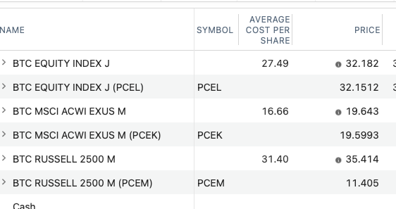

I have a 401(k) at Fidelity. I own three index funds that do not have ticker symbols. Every once in a while (including today), when I download transactions, Quicken tries to match the fund name to a stock ticker, and adds those shares, doubling my balance. For example, I own BTC Russell 2500 M - Quicken tries to match it to PCEM, and adds PCEM shares equivalent to the BTC Russell 2500 M quantity that I own. It does this will all three of the holdings.
See below. I can remove the stocks from Quicken and delete the transactions, but every time I do an update, it puts them in again. . .

I had a similar issue and reported it to Quicken. My issue came from my NetBenefits account (401K). Fidelity actually downloaded my holdings in a new format with a symbol which was never included. The system added the shares and then deleted some of the old, but not all. The result was not an exact doubling of my account value but more than expected. Also, my history was lost for those shares deleted so the history which i use to track total performance over time is gone. No cost basis for the new securities downloaded.
