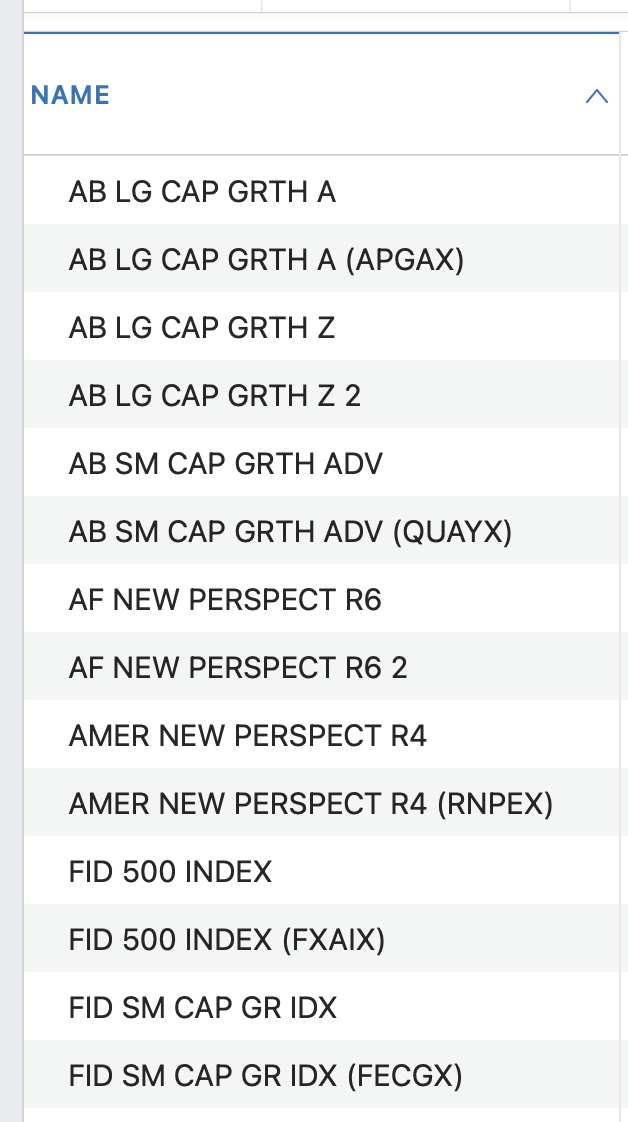

Quicken is showing 14 funds but there should only be 4. Again, trying to sort this out manually is a challenge.

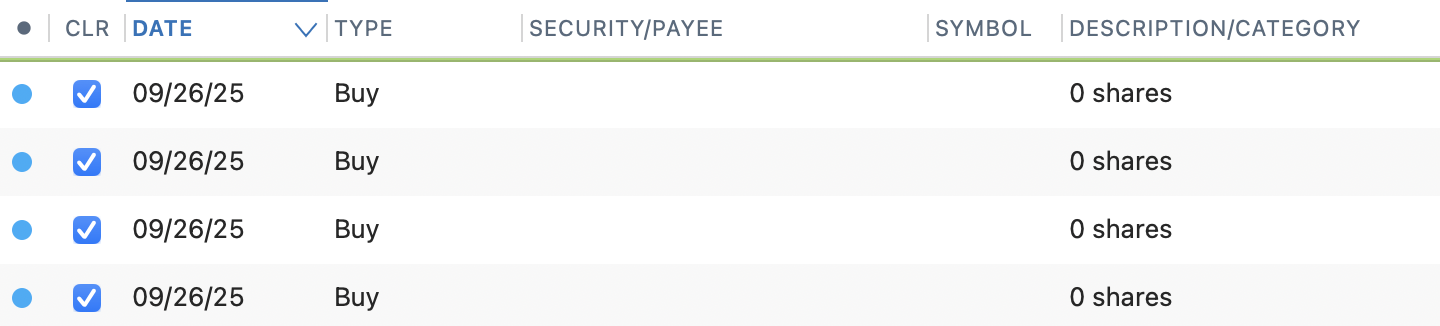

I'm so confused as to what should be fixed and what is still being fixed, but my 401k still downloads 4 0 share transactions every week when it should be downloading 9 transactions that are not 0 shares

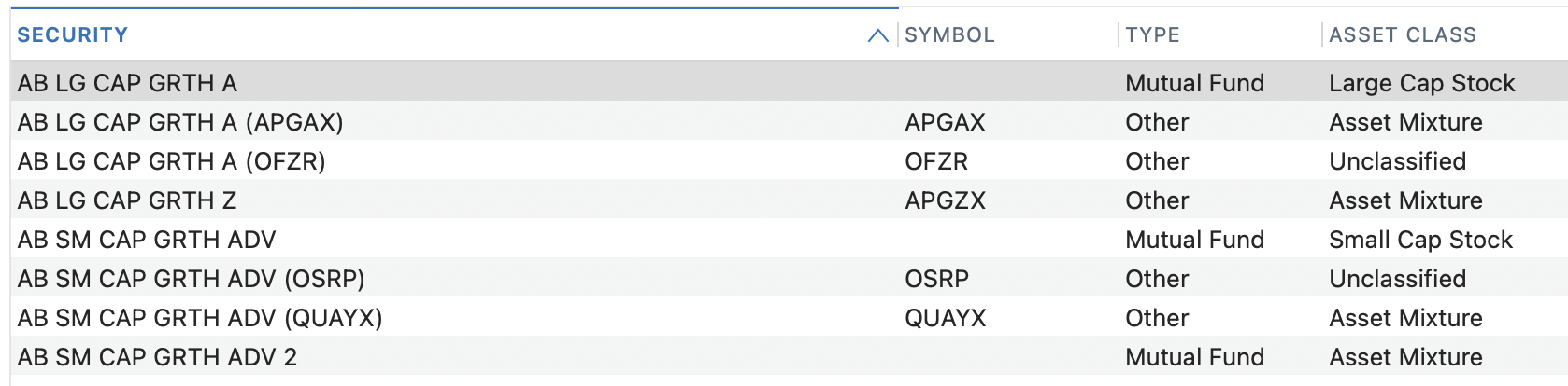

Thank you for your reply @richakaye,
It's hard for me to say, because I don't know what should be in your account in the first place. Looking at your screenshot, without knowledge of which securities should be in your account, it looks like 7 sets of duplicates.
How did all these extras appear? Did they all appear at once when you migrated your accounts to the new connection method, or have more variations appeared over time?

Thank you for sharing your experience. To help troubleshoot, please provide more information. Is this happening with Fidelity? What kind of transactions should these be (buy, sell, short sell, etc.)? Is the account cash balance and market value reflecting correctly?
@Quicken Kristina it's a fidelity 401k. they should be buy transactions. Quicken keeps adding remove shares placeholder transactions to make market value incorrect but when I delete those and manually add the weekly transactions that Quicken is not downloading correctly, the value is correct. I just have to keep scrolling to the bottom of the register to see if any new placeholder transactions have been added. there's no cash in the account.
Thank you for your reply @hurwi,
What kind of holdings are these remove shares transactions for? Are these placeholder transactions try to remove the same holdings that you're manually updating?
@Quicken Kristina last update they remove ALL the shares of 2 holdings. It seems to vary each week as to what Quicken is adding as placeholder transactions or downloading. There are 9 holdings in the account and they all need to be manually updated each week because downloads either download 0 share transactions or no transaction at all.

Hi @Quicken Kristina ,
Yes, all the confusion started when I updated to the new connection method.
I'm attempting to use the merge securities strategy I've seen some others here post about. I made a backup and then began. As you can see from the sample below, Q has the same fund associated with different symbols. I have merged a few others and each time it prompts me to pick the one I want to merge into, then warns about one or more transactions with dates that have discrepancies. I have no ability to make a considered decision so I'm just…guessing.
I've had a bit of a breakthrough and have managed to get my Fidelity account back to something resembling reality. After messing around with deleting placeholders, making wild guesses about what I could remove, and merging securities, I switched the account settings to use the Simple Investment Tracking Method. After doing that I synced the account. Like magic, my balance is now nearly identical to the penny when I look at it directly via the Fidelity site. I then switched it back to Detailed mode and the proper balnce stuck. Q did add a fairly large adjusting transaction but I can ignore that. Hopefully this trick helps out others.

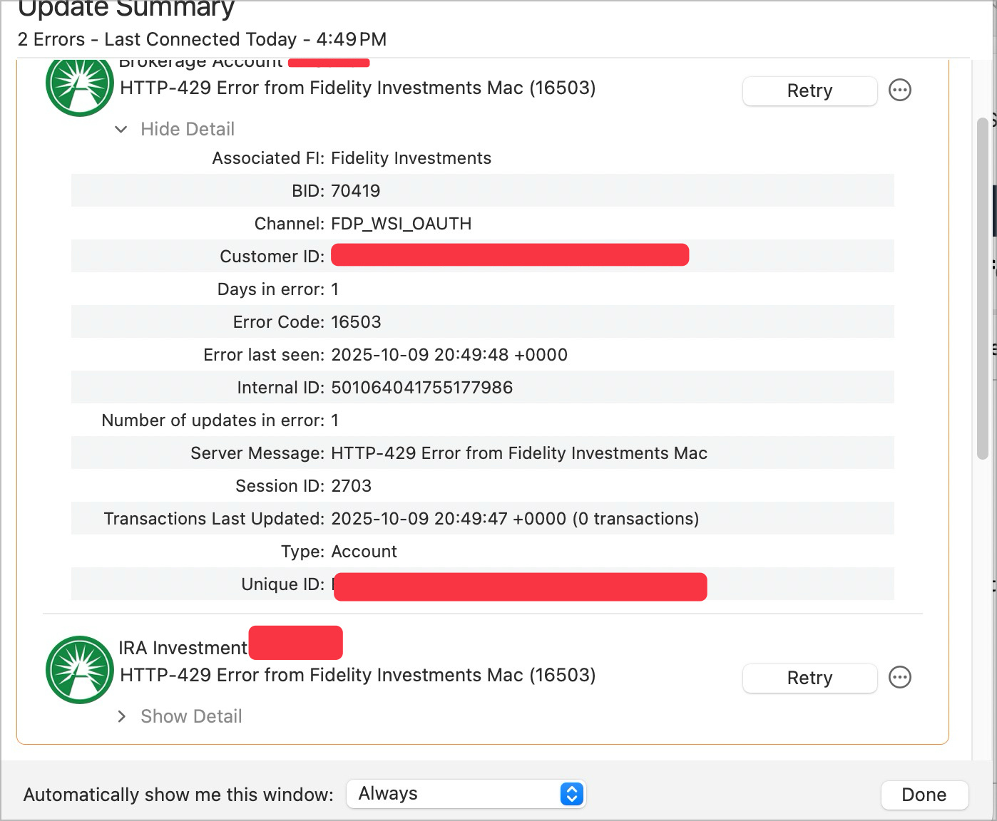

Is Fidelity now forcing us to move to their new mess of a connection? I'm now getting error code 16503 when I try to update on Direct Connect.
Me as well. I posted in another topic. Should have been here. Windows still works DC. Looks like DC in Mac has been abandoned if it is not an error message in error.
Can someone @quicken confirm or deny?

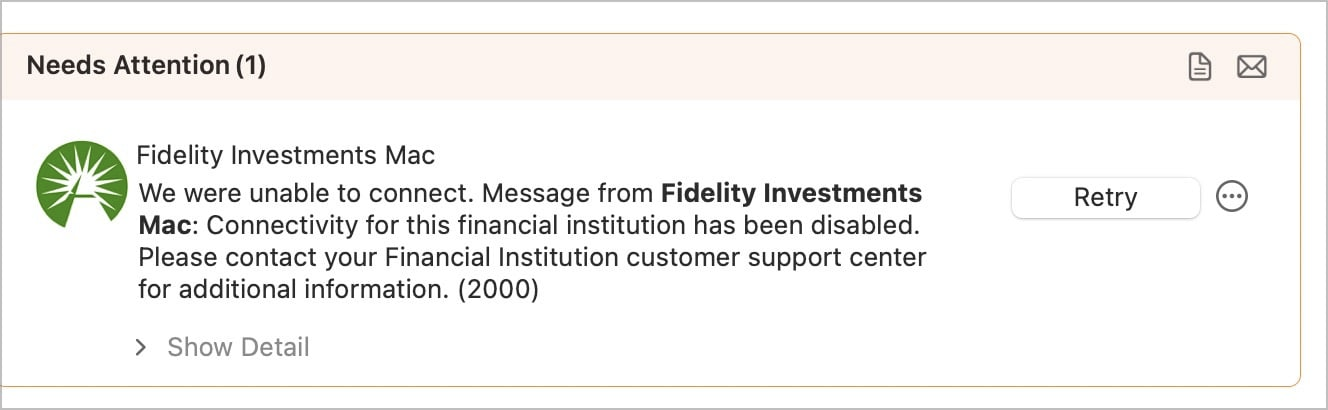

Error 2000 When Adding or Updating Accounts in Quicken for Mac0
Same. It seems ridiculous for DC to be disabled when the new connection is such a mess. If I switch over to the new connection today, will it ruin 10 years of history? The last time I tried the new connection, I managed to fix most of the problems. Then when I updated the next day, all the work I did was undone. None of us have hours to spend trying to correct our account balances ourselves.

I contacted Quicken support. The guy said Quicken can't see Direct Connect errors, only Fidelity can see them. Now I'm wondering if Fidelity pulled the plug on Direct Connect and didn't tell anyone.

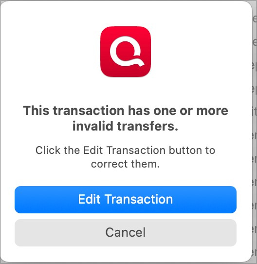

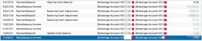

Now, unsure if since Mac or since EWC+ but I have a number of error transactions going back years.They are not in my Windows Quicken with Fidelity at DC. All seem to be similar. How do I fix these or should I leave them be?
