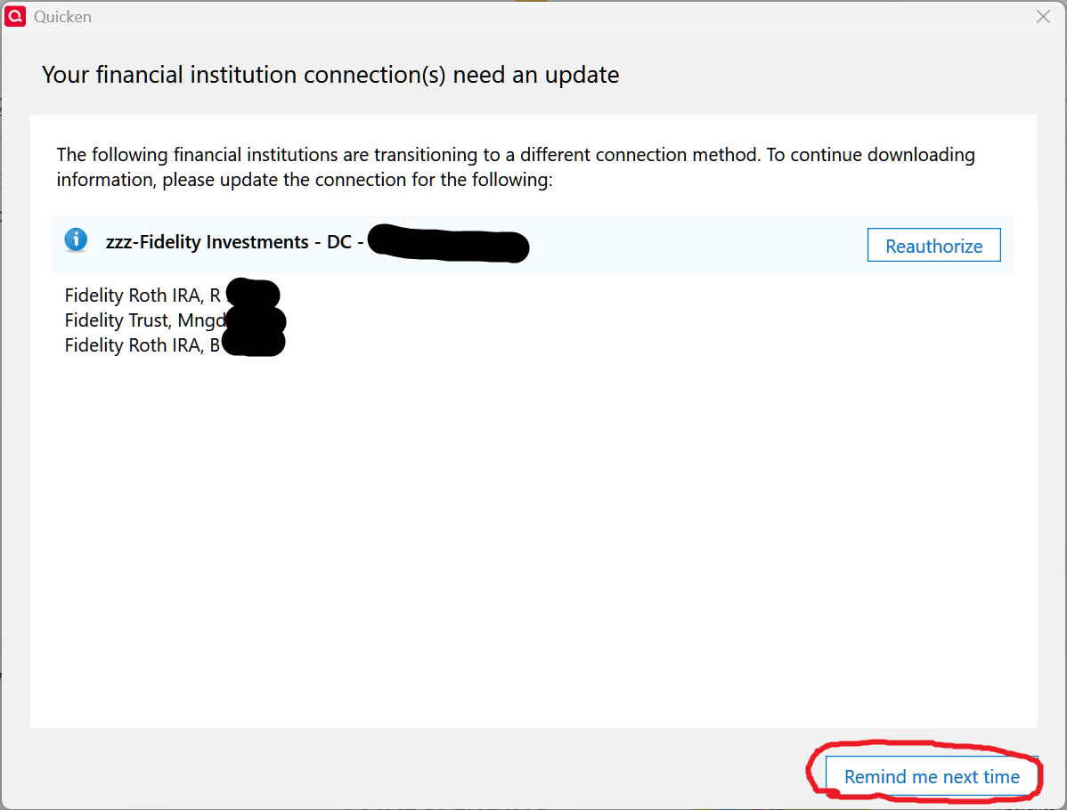

Answer to TWO:
This is the prompt from today.

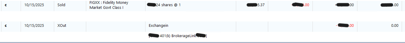

My spouse's 401(k) BrokerageLink account downloaded an incorrect transaction with EWC+ today:
Should have been an IntInc with a positive amount. Weird thing was my account downloaded a correct IntInc for a TIPS today.

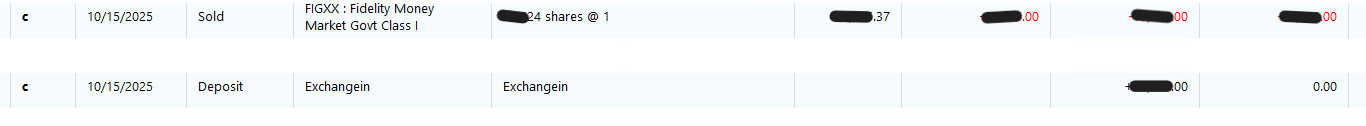

More polarity errors in my regular 401(k):
This was a sale of FIGXX and a transfer out to the BrokerageLink account. I fixed it as such:
Removed the minus sign in the Sold amount and changed the Deposit to XOut.

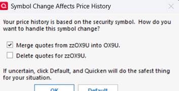

Different topic re Fidelity NetBenefits on EWC+. Things slowly getting better: Problem: For one of my non-public funds in my 401k through NetBenefits, its not pulling in historical prices and I have over 10 years of history which impacts the Investing tab and various reports / graphs that have historical information. I’ve been unable to successfully match them. I think this is because CUSIPs are being filled in differently and/or Quicken can’t match for some other reason. My solution was to export the old security price history and import it into the “New Security Name” in hopes that One Step Update then syncs having the historical prices in it. (It worked and has been ok now for about a week).
Create Backup. Reset Quicken NetBenefits Account in Account Details Online Services tab. Got the question, was the security renamed? I selected “It was renamed, but will update this myself”. The new name only has prices from 9/19/2025 to current. Quicken’s AI ChatBot told me to make up a symbol since the fund is non-public. I put a “zz” in front of the symbol that Fidelity has in the download (Fund Code). Made the symbols the same for both securities.
https://community.quicken.com/discussion/7871099/exporting-security-prices
Exported price history. Opened in Excel - Delete out first 5 rows (including header info) and High/Low/Volume columns. Create a new column A named Symbol and copy/paste the ticker symbol you are using for all the records. File should have 3 columns (Symbol, Date, Price). Save excel file using Save As, CSV comma-delimited.
Import using the following directions
https://community.quicken.com/discussion/7893435/import-security-prices-from-csv-file
If successful – create additional backup point just in case.
In the security name in Quicken (old one) clear out the Symbol so its blank (not public anyway)
In the security name that Fidelity is now using (new one), remove the ‘zz’ from the ticker symbol and merge quotes. Price history will now be in the new security name and should match your old security.

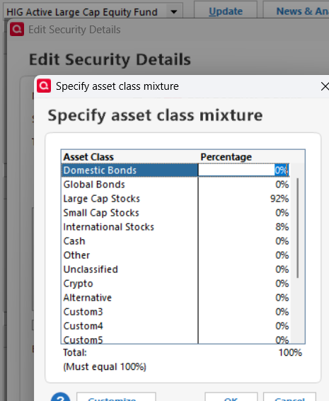

Fix Asset Class Mixture for new security while at it as that also isn’t downloading.
Go into Account for Netbenefits 401k. Click Edit Account Details Icon. Click Online Services. Reset Account or Deactivate/Reactivate Online Setup. Price History remained in the new security name and included the most recent day.
NEXT STEP – MOVE ALL TRANSACTIONS TO THE NEW SECURITY NAME – Manually change each transaction to the new security name. Long copy paste save transaction exercise. Sort on security name to group them all and go one by one. I ran One Step Update and subsequent days price has downloaded correctly.

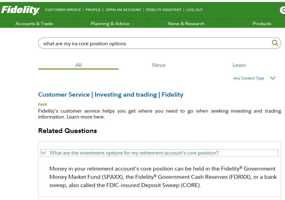

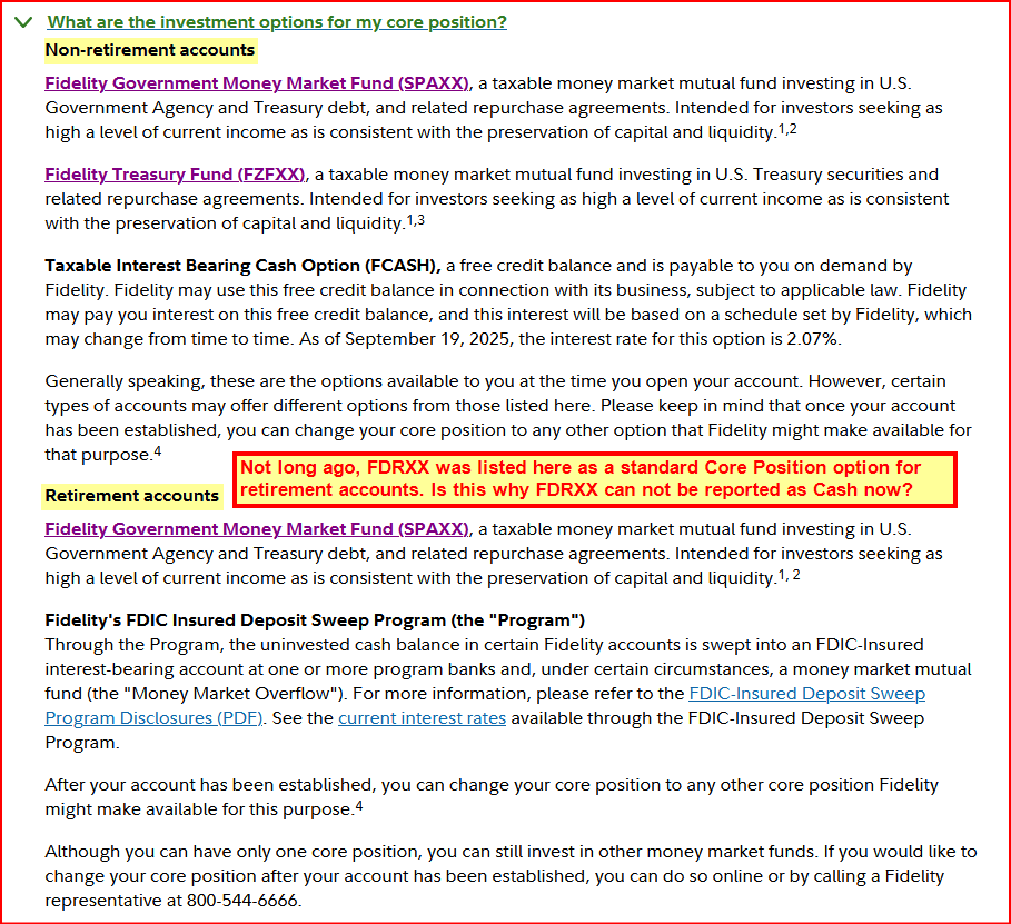

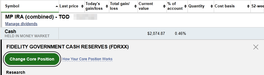

I noticed a recent change on the Fidelity website regarding Core Position/Account options. In the past FDRXX was listed as a standard option for Retirement Accounts but now it is not included in the list. If Fidelity has indeed removed FDRXX as a standard Core Position option then is that perhaps the reason why we are no longer being given the option to have it reported as Cash in Quicken….even though in our online accounts FDRXX is still listed as the grandfathered-in Core Position?
FYI: This list of Core Position options is the list of standard options available to all investors. There are a few other options that are available for high net worth investors but they are not listed in this article. To see the options that are available to you, you can click on the Core Position in your online Fidelity account and then click on "Change Core Position". If you are eligible for other Core Positions they will then be listed there. Or you can call Fidelity and speak with a representative who will be able to tell you which Core Position options you are eligible for.
Quicken Classic Premier (US) Subscription: R65.15 on Windows 11 Home
Interesting, FDRXX still shows up as the core position for my IRA.
Deluxe R64.30, Windows 11 Pro

Yes, my IRAs and Roth IRAs also show FDRXX is the Core Position. So, it made me think that if indeed Fidelity had changed the standard Core Position options (removed FDRXX) then they probably would have kept FDRXX intact as the Core Position for Retirement Accounts that were previously set up with it. That is why I mentioned that maybe being FDRXX was "grandfathered-in" meaning that perhaps new accounts could not be set up with it or existing accounts could not be changed to it.
But what you posted from the Fidelity website showing that FDRXX is still a Core Position option for IRAs maybe means this might simply be a matter of conflicting documentation on the Fidelity website and we really don't know whether or not something has actually been changed regarding the Core Position options. (Sigh!)
Maybe if someone has a retirement account where the Core Position is SPAXX or a Sweep they can check to see if they can change it to FDRXX. That would help to clarify this.
I have SPAXX as my Roth core MMF. FDRXX is a core option for the account. Just to make sure, I called and asked Fidelity as well.
