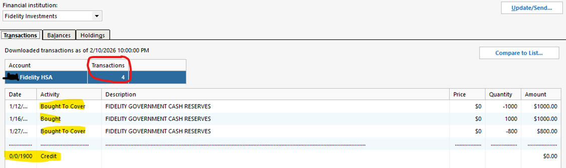

(a) Downloaded transactions are not occurring. Nothing or blank entries with bogus dates(0/0/1900 or 0/0/2027) are seen in Quicken Online Center and Quicken account register.
(b) Quicken Online Center "Transactions" tab shows unknown entry with Date of "0/0/1900", Activity of "Credit", and Amount of $0.00. Can this be explained/expected?

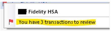

(c) Ever since initially doing the first "Download transactions" for this account in 12/2025, a red flag indicating 'You have 1 transaction to review' has existed next to the Fidelity HSA account name label in Quicken. There have never been any functional downloaded transactions to date, so I don't know what this 'phantom' transaction is referring to? How can I permanently get rid of this red flag?
(d) Within the Quicken Online Center, there is a "Transactions" column under the "Transactions" tab. My experience is that this is supposed to be a counter of outstanding unaccepted transactions. However, I am seeing strangeness/randomness? of Quicken sometimes counting the $0.00 transaction(one per account) as part of this count(ie, 1) and sometimes not(ie, 0). To further complicate this, I have had times where I click on a specific account name under the "Transactions" tab and this value immediately changes from "0" to "1"(haven't ever seen it go from "1" to "0" from just clicking the account name; however, it has gone back to 0 from something occurring within the app, then back to "1" again after I repeat the same account name click within Online Center). Can someone explain if any/all of this is normal or not?
