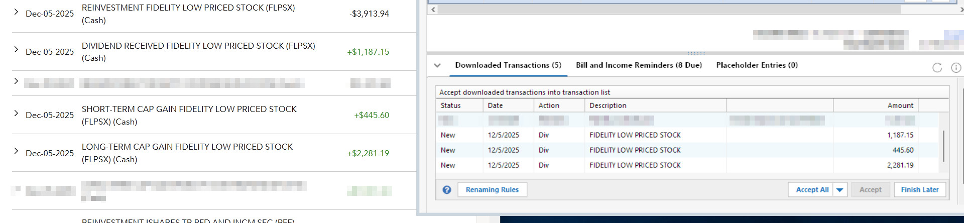

Here's an example of what Fidelity shows in its transaction Activity:
and here's what Quicken downloaded:
With the DC connection, Quicken correctly set the Action to be CGLong or CGShort accordingly.

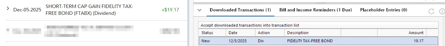

Update: Quicken is still treating downloaded Short Term Capital Gains Distribution as Action=Div instead of CGshort for Fidelity.
Long Term Capital Gains Distribution had the correct Action=CGLong in Quicken.
This used to work correctly with Fidelity DC connection.
Deluxe R65.29, Windows 11 Pro

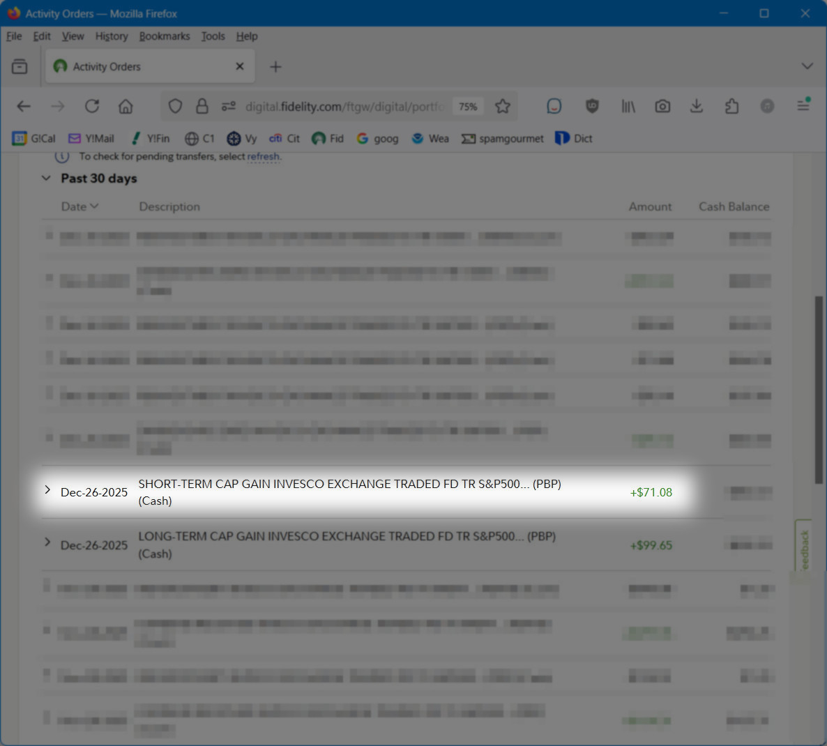

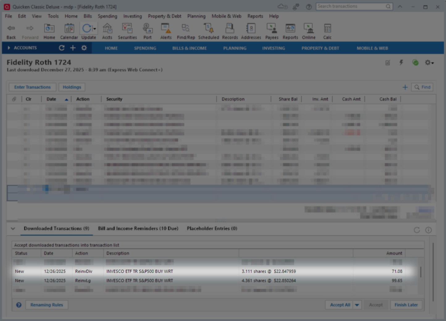

For today's transaction downloads, Quicken incorrectly treated a Short Term Capital Gains distribution download of NBOS for a Fidelity account as a ReinvDiv instead of correctly treating it as ReinvSh. This issue does not appear resolved.
I updated to R65.29 and the problem still occurs. I have reported this problem again.

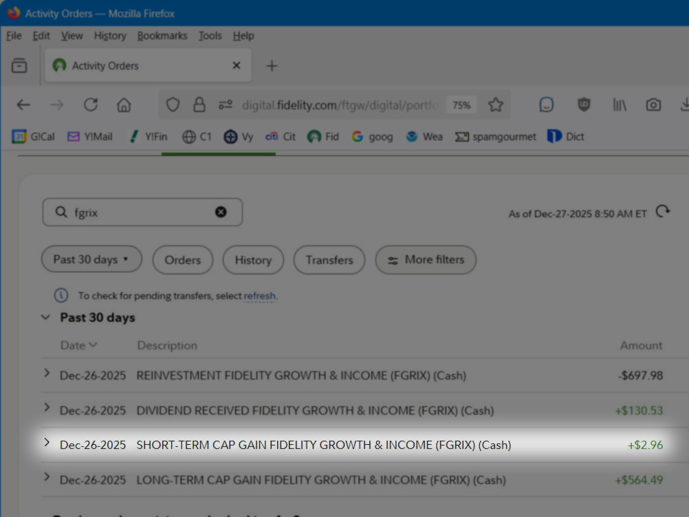

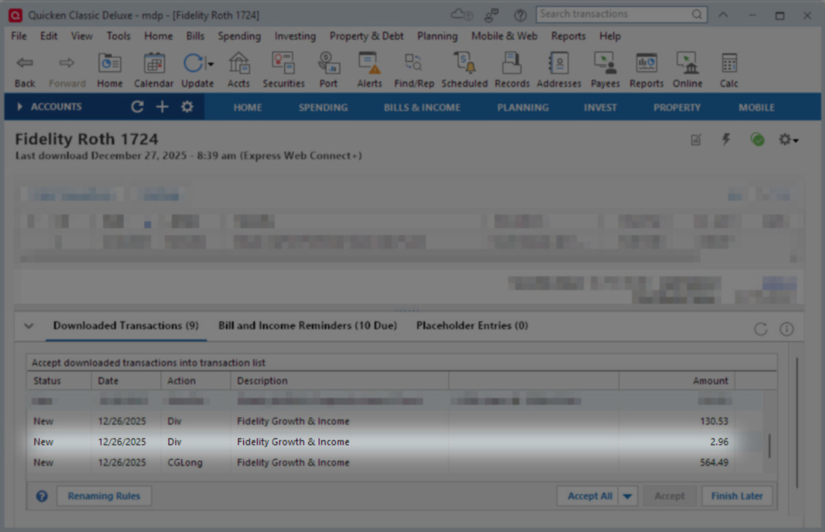

Well, 2 steps forward followed by 1 step backwards.
In 2 accounts, a CGShort that Fidelity paid 12/26 (Select Financial Services) download as a Div in IRA accounts.
There was also a regular Div paid on that fund, so the 2nd Div transaction was pretty obvious.
I realize that the specific action doesn't really matter in IRA accounts … but I like to keep things accurate.
