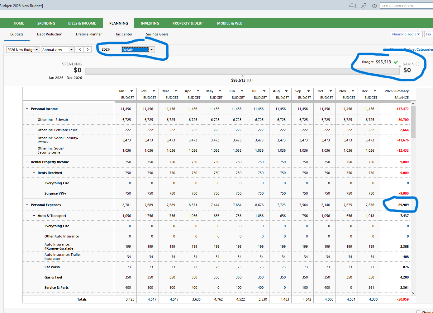

Nope it didnt identify why the $5604 discrepancy. The custom report did show a $95513 total expenses (as I showed in original question, the line item budget total shows $89,909) , but its still a wonder to me where is the $5604 at?
I did just find that the budget rpt I posted that shows a total of expenses at $89,909 does NOT EQUAL the accumulated monthly personal expenses for each month shown. If you add them all up they equal the $95,513. SO, why is the budget rpt not adding things up correctly? Or why is it deciding to exclude something?

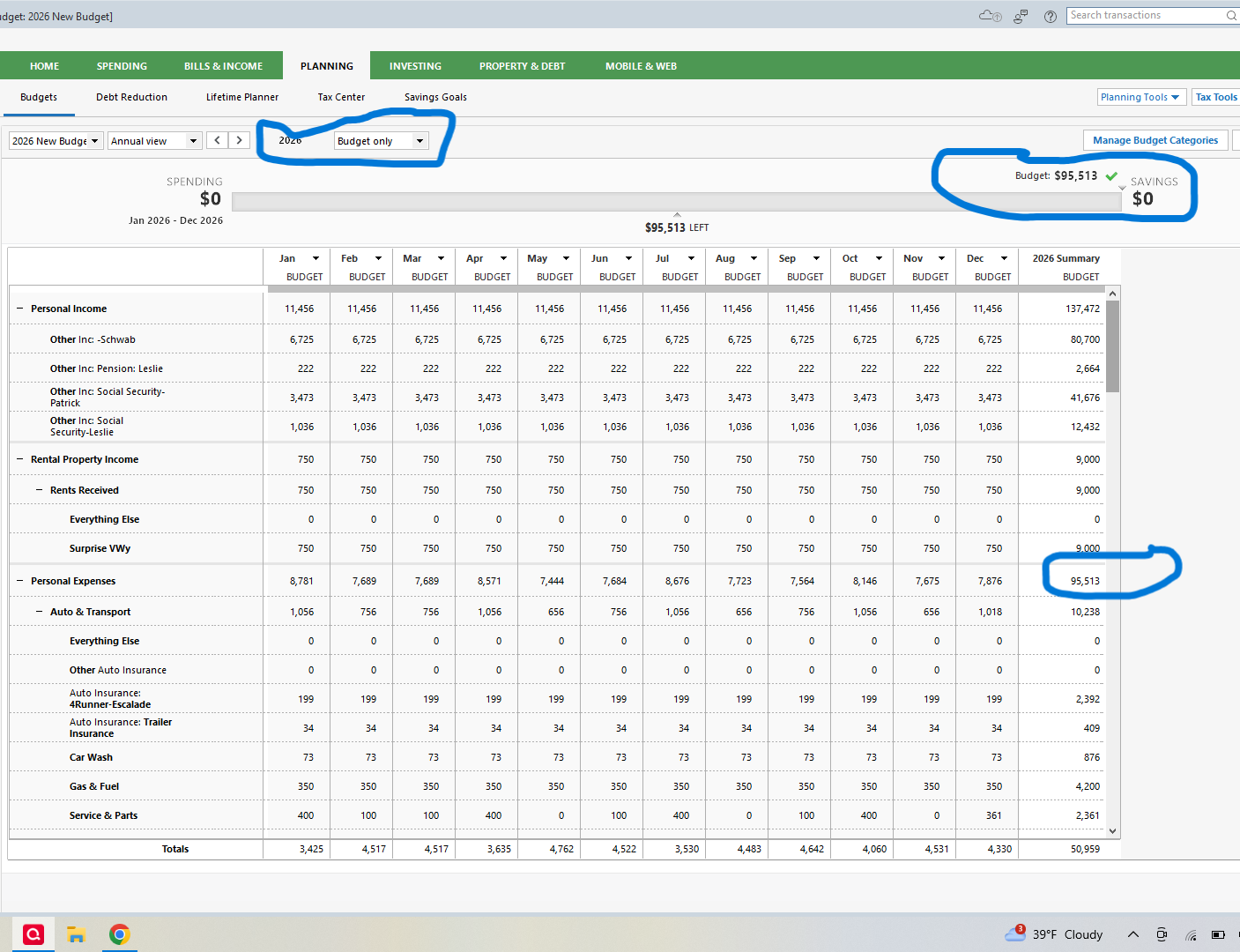

ALSO and whether it helps lead to what I'm calling a "discrepancy", in the new screen prints below the top one is like the original where you see the discrepancy WHEN YOU USE the drop down menu for which particular view you want i.e. detail, balance, actuals, or Budget Only. So in the top example I had used the "details" view and as you see there's the discrepancy. HOWEVER when selecting the "Budget Only" like in the bottom screen print NOW EVERYTHING MATCHES!!! Or adds up as I'd expect. So that's kinda good news though it still bugs me as to what is the system pulling from to cause the $5604 discrepancy ….😕
For anyone wondering, I'm now quite certain the issue I've presented revolves or involves the "roll-over" feature, even though the categories I've selected DO NOT have the feature engaged in my new 2026 budget. That said my 2025 budget did have a few line items that used the roll-over feature and I'm guessing that when I created my 2026 budget I did use some kind of "duplicate categories" or similar type new budget creator gadget to create my 2026 budget. Visibly there's no doubt my new budget DOES NOT physically show/have ANY line items using the roll-over thing however it's pretty obvious when using the "Details" view, that when in that view, it's still applying/using the rollover line items from 2025 to my new 2026 budget…..Quicken, you buying what I'm selling??😉
