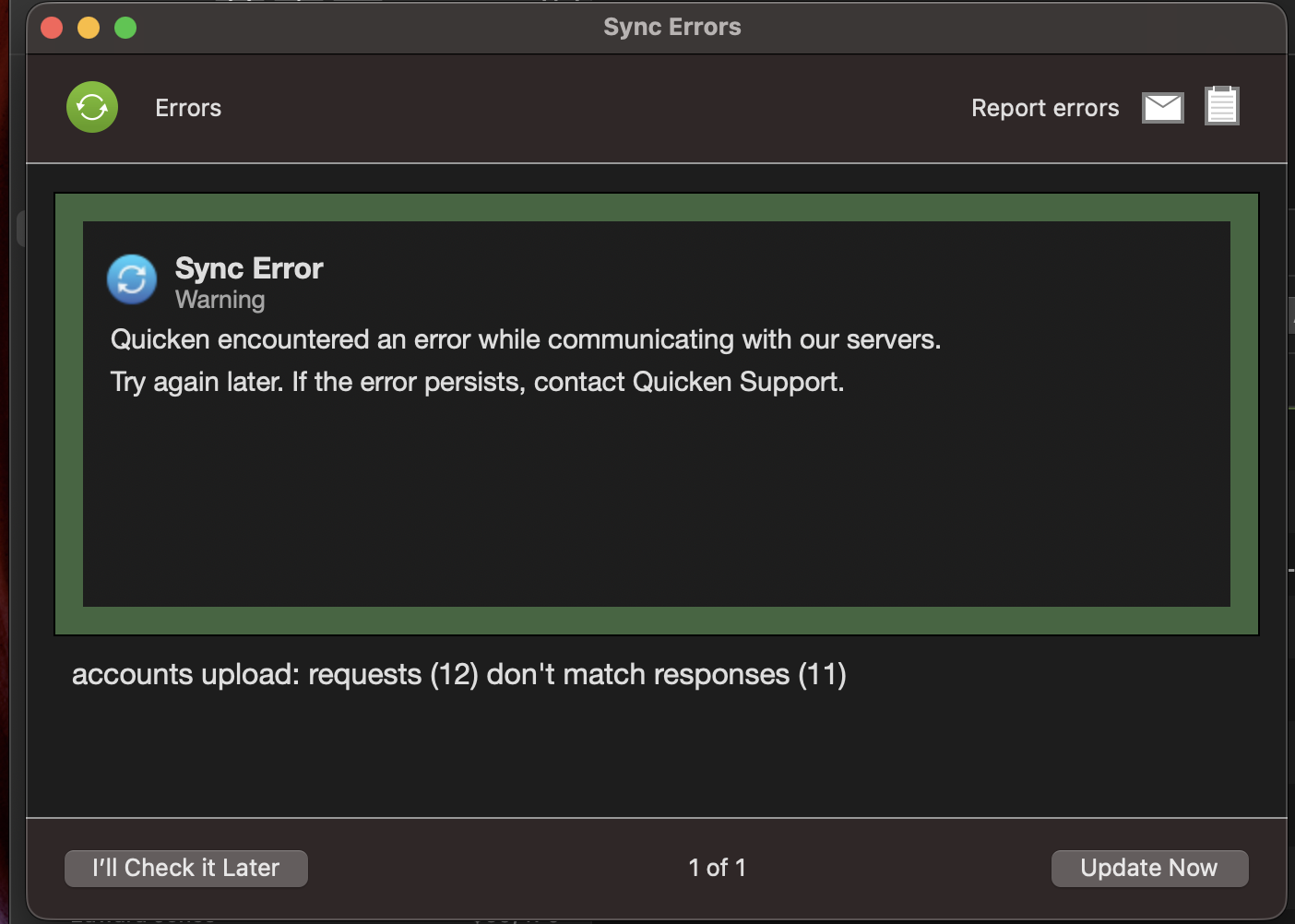

    I never got this error message before the last update. I do not have Sync turned on because I want as little of my financial information on the cloud as possible. The only solution you're website offers doesn't apply because my Sync is turned off, always has been. Quicken still connects to my various accounts and downloads transactions, but then this error message pops up all the time now. How can I stop this message? Thanks

    After the latest Quicken update I have been getting Sync errors.
    Has anyone else? This appears to be a Quicken communication caused problem and I have not seen yet how this affects my quicken balance accuracy but know it can't be good.
    I've attached a screen shot of the error.
