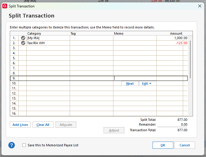

This problem appears even if the transaction is entered directly in the receiving account prior to 4/15. Here is what the directly entered Split transaction looks like:
When I enter the transaction, Quicken asks if it is a payment or deposit. I select Deposit and click on OK

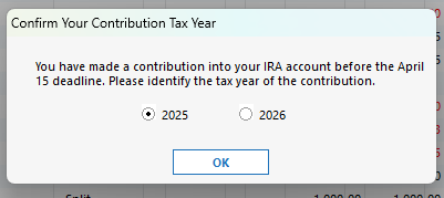

When I enter the transaction by clicking on the green Enter icon, I get the problem dialog:
It is asking about a contribution even though this is a distribution. Also it defaults to last year. If I accept the default, the distribution appears on the 2025 Tax reports.
Note that per IRS regulations, except for the first year you take Required Minimum Distributions (RMDs), you must take the RMD before Dec. 31.
If I select 2026 and click on OK, the transaction is entered correctly.

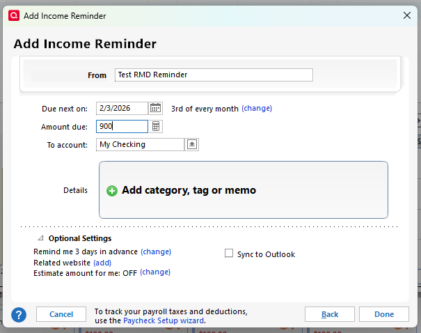

To set this up as a Reminder, I click on Manage Manual Bills and Income and select Add > Income Reminder and set it up as shown
I click on Add Category, Tag, and Memo and again set up a split like this
I click on Done to save the Reminder.
When I Enter the Reminder, I get the same "Confirm your contribution tax year" dialog as above.
