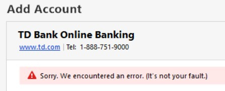

I am still getting an error when trying to disconnect and re-add TD Bank Online Banking.
Hi John …
While others have had some success reestablishing their TD Bank Direct Connect you've been unable to get through it. As I understand it, you complete steps 1, 2 and 3 - leaving you in Quicken with the error box you just posted. With Quicken still open and the error box still showing, you go back to TD Bank's web site in your browser, and attempt to complete step 4:
Activate at TD Bank - in Account Services - Manage Linked Services - Manage Settings - Financial Tool Access allow access for Quicken Windows 2018
But nothing shows up in the Financial Tool Access section.
I just went through the sequence again and one thing I noticed was that I had to logout of my existing TD Bank browser session and then log back in. When I tried it using my already existing session nothing showed up…after logging out and back in, the request appeared after I clicked the green Financial Tool Access link.
I don't know if that's your issue, but let us know if that fixes it or perhaps provide more detail on each of the steps you taken if it doesn't.

Broken again this morning. Same issue, OFXlog does not show a SEND to TD's OFX server, etc. Ran supervalidate. No errors. Then got a normal Direct Connect OSU.
Dave526 - My mistake from the other day as I was doing the steps from memory and I did not perform the account services stop/start othe TD Bank website. I did that again today and was able to reconnect with Direct Connect. HOWEVER, the update process with Quicken is still almost instentaneous and does now download anything so I will have to revert back to the other connection method so at least I receive downloads from my account.
did you do a supervalidate? after performing all steps?
Yes. Sorry I did not mention that before.
