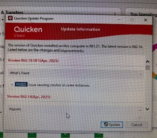

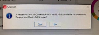

If you don’t mind, could you please provide a screenshot of the error message you described receiving? If needed, please refer to this Community FAQ for instructions on how to attach a screenshot. Alternatively, you can also drag and drop screenshots to your response if you are not given the option to add attachments. Please remember to redact any personal information as needed.

It is my personal computer and I only operate in administrative mode. (There are no other users set up for the computer). Prior to the last update (I think in February) the updates would happen seamlessly, so I don't know what is different now. I gave it some time to see if it would resolve itself, but it hasn't. Here are three screen shots:

Hello @Todd 910N,
Thanks for providing more information!
Have you tried uninstalling/reinstalling Quicken? Please refer to the following support articles for instructions on uninstalling here and reinstalling here.
