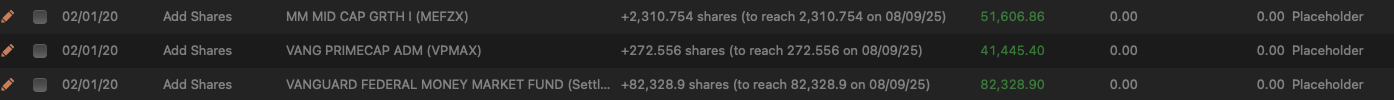

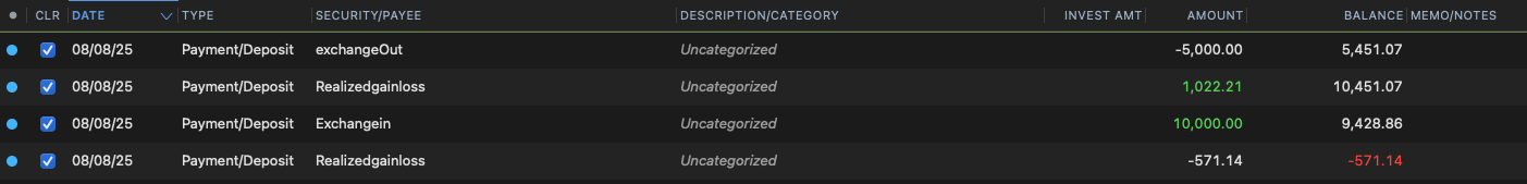

- Yesterday I tried to rebalance some accounts in Netbenefits (fund exchanges). This is what I see today when I update:
That's not information that I can use. And it leaves my account with a cash balance that is incorrect.
3. But wait! The share holdings are also updated using a pesky 'placeholder'!
4. So I have → the correct # of shares in this account as of today → an incorrect cash balance → no record of the actual transactions (only the magical placeholder).
It's a mess.

There are always hiccups with these switchovers, and the one with Fidelity is no different. The common culprits reported (and what I have personally seen for NetBeneftis) are as follows. It took me about 15 minutes to clean up.
- Your funds are now being reported with a slightly different security name (albeit same ticker), hence the doubling. To fix, (after making a backup): Go into Windows: Securities and locate the two matching funds. The new one will typically have a blank "Type", so you will want to set that to the correct one which is typically Mutual Fund. Then, select the two matching ones, and click "Merge Securities" at bottom of window. Follow the prompt about which name you wish to use going forward (I used my old), and you might get a warning about a few price history incosistiences. I knew mine were correct, so I ignored. Repeat for each duplicated fund, and those placeholders should disappear. Even before this conversion, Fidelity did this about every 2 years, so I was familiar with the exercise .
- You get a few (and often unknown) indescribable recent transactions. In my case, I was able to simply delete, and the cash was correct. From your screenshot, though, they may be more recent transx that are needed, but not correct. I suggest deleting them (as they are erroneous (cash transx) to begin with.) and evaluate your cash balance. If a mismatch, then you will have to check at the NetBenefits website under recent activity if those are recent transactions that you will have to manually enter so your file is correct for now.

@John_in_NC Thanks for the Securities > Merge Securities guidance. This does indeed get rid of the pesky placeholders. Things look better now, if not yet 100% correct - I still have some things to clean up.

Fidelity Netbenefits is still broken. Automatic monthly transactions downloaded as 'Contribution' 'Uncategorized' and the specific fund purchases are not recorded. Also, missing transactions. It's a mess.
