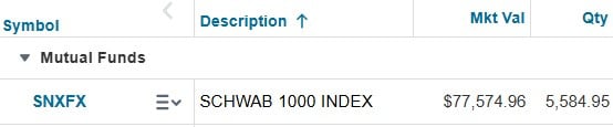

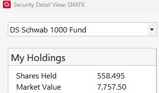

after updating the shares in a specific mutual fund in Quicken are off by a factor of 10, I have 5,584.95 shares in my account but after updating Quicken only shows 558.95. I check quicken daily and there hasn't been a problem until now. But now it shows the error started 5 days ago n the 11th.
I'll assume this will get corrected but has anyone else found similar errors with Schwab updates?

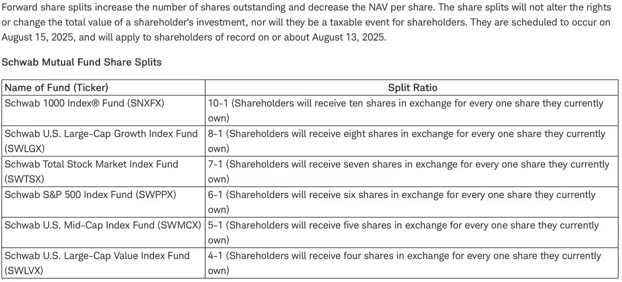

I believe these are the 6 mutual funds that were impacted as per boglehead.org

attached are screen shots. one from my schwab account and the other from quicken. I also submitted a problem report but although the check box for screen shot was checked there was no ability to add a screenshot to the report. drag and drop did not work and there no other options
I have two funds where this happened (SWLVX and SWMCX). There was a split on 8/15, but the downloaded prices showed the "after" split prices starting around 8/11. The details downloaded from Vanguard for the Schwab funds in the portfolio didn't have the fund split details. It only added the new number of shares. I found the correct prices from 8/11 - 8/15 on Yahoo finance and entered those in the price history. I also changed the downloaded transactions from "Added" to "StkSplit" and used the details from Yahoo Finance to fill in the missing information.
I have no idea why Quicken used the after-split prices starting on 8/11, but after correcting the prices from Yahoo finance and changing the downloaded transaction from "Added" to "StkSplit" my holdings are correct for the 8/11 - 8/15 time period.

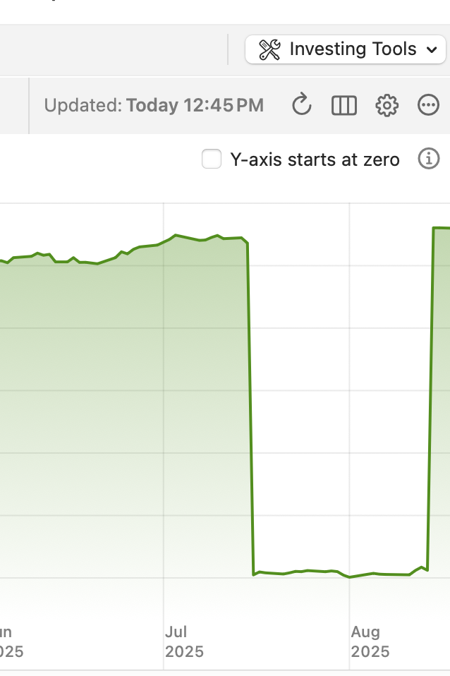

My problem is similar to ,@Dave hulett, @bps42, @st farris; but a little different.
On July 16, my share price for SNXFX (Schwab 1000 index) dropped by a factor of 10. I didn't notice a problem until 8/15. I check my portfolio total for Schwab on the sidebar daily, but only occasionally the portfolio details. I had not noticed any changes in the portfolio value.
Today, starting with 7/16, I manually corrected the share prices by moving the decimal. I periodically checked the up to date screen and all was fine. Then when I corrected the share price for 8/14, my total shares jumped by a factor of 10 (and I became wealthy in Quicken 🙄).
I reverted to my 8/16 backup and SNFX shows in the anomaly depicted. Again, the anomalous drop in value did not appear in the sidebar total for the previous month. So the problem manifested on or around 8/14.
Also experiencing this problem with the Schwab mutual funds (SNXFX and SWLGX). As per Schwab website (the correct value) I should have 8,263.64 shares of SNXFX. But Quicken on PC Windows shows 826.364 shares. So, I now have 1/10 the shares showing in Quicken.
Schwab website shows I have 14,890.744 shares of SWLGX. But Quicken shows 1,861.343 shares. So, I now have 1/8 the shares showing in Quicken.

The only "bug" that occurred here is that Schwab did not feed the mutual fund price split into the feed that Quicken downloads during a one step update. There's nothing that Quicken can do about this I believe . The price post split was correct (from the One Step Update) but the split itself was not recorded (as mentioned, it wasn't part of any OSU). To fix this, simply manually enter a stock split using the appropriate "X for one" split amount depending on which mutual fund you had as you saw in crissnyder's post earlier. Once you do that, your holdings ( number of shares, price per share, total value) should be correct. Verify this on your Schwab online positions.
By the way, for those that are 'freaking out' (or upset, or whatever) about this, Schwab announced this was going to happen months ago. https://pressroom.aboutschwab.com/press-releases/press-release/2025/Schwab-Asset-Management-Reduces-Fees-on-Four-Equity-Index-ETFs-and-Announces-Mutual-Fund-Share-Splits/default.aspx

My wording could have been better (posted the original late last night after coming back from vacation and also being 'surprized' by this). When I said "Schwab did not feed the mutual fund price split", I really mean the number of shares (Eg: 10 for 1, 6 for 1, etc.) split wasn't sent, not the price per share. The downloaded price was correct (both pre- and post- shares split) which is what caused all the issues in the total value. Sorry about that inaccurate wording.

SNXFX did a 10 for 1 split in July. PERHAPS, did you input it backwards?

Schwab shows an 8/16/25 SWPPX split 6:1 share quantity of 340.345. Is that the pre or post share quantity?
If I multiply today's share price of roughly $16.72 the new market value would be $2042.07 which doesn't match the account market value
How many shares did you have prior to the split? According to my Quicken d/l, the price went 6 for 1 between 8/8 ($98.80) and 8/11 ($16.4283). So see if entering a 6 for 1 split on 8/11 helps.
