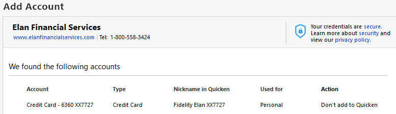

I have been using the download feature from Fidelity Elan for several years successfully. The transaction download has stopped working for my account. Goes through the motions but no new transactions are entered after the download. I have tried the following:
  1. Reset account from online services - failed to download
  2. Deactivated account and reestablished link with continued failure to download.
  3. Created a new account in a new file with appropriate 90 day download successfully.
  4. Tried to establish a "new" account in the original file for Fidelity Elan and it found the accont but the only option available was "Don't add to Quicken".
Looks like things are working OK on the Fidelity Elan end but something is broken between my Quicken file and Express Web Connect as it reports, "Last download August 17, 2025 at 6:23am (Express Web Connect)

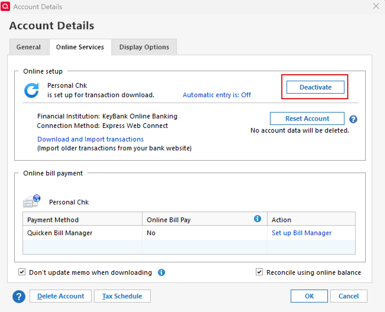

    1. Back up your Quicken file before making any changes.
    2. Go to the Accounts List and select your Elan credit card account.
    4. Once deactivated, go to Tools → Add Account and search for Fidelity Investments.
    5. Follow the prompts to reconnect your credit card using your existing login credentials.

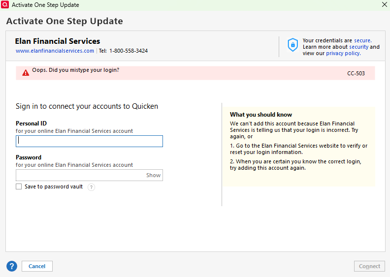

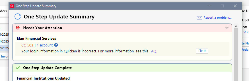

    I have not been able to update my credit card account all morning. I get a "CC-503" error. When I tried to reset my connection, Quicken will not take my login information. I have triple-checked that I am typing in the correct information, even going so far as to copy my information from the web browser (that works) to insure there were no issues. Still not working, so I'm not sure what the issue is. Anyone else having this issue with Quicken/Elan Financial? If so, how did you resolve?

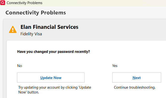

    Same here. I did a One Step Update and my account ask if I have changed my password. I responded "No" then after a few seconds I get a "Successful" response but not transactions and the Online Center has a CC-503 error. I even went to the account and did an Update Now and get a green complete but then the Online Center still has the CC-503 error.
    I haven't changed my password so it has to be between Quicken and Elan. I can login to Elan using my credentials with no problem.

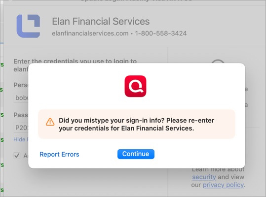

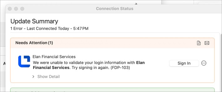

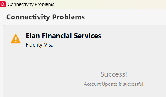

    OK, happening for me, but a bit differently.
    In Windows I do the fix, enter password and works. I get "Success". Until the next OSU and have to do it again.
    In MAC, it will not take my password at all.
    OK. Will try first to change to Fidelity (though that used to have its own set of errors with the credit card) in Windows. Then MAC if that works. If both are not successful, I will report back here.
