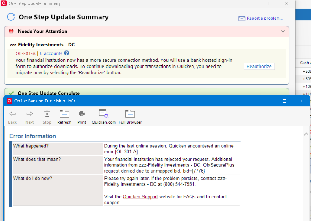

This morning the DC connection gave an OL-295-A error. This afternoon, it gives:
It reads as if DC connection is no longer available for me. Quicken experts: is that the correct meaning of "OfxSecurePlus request denied due to unmapped bid, bid={7776}"?
Deluxe R65.29, Windows 11 Pro

There is a Community Alert for the OL-295 error. You can correct the issue by migrating the accounts from Direct Connect to Express Web Connect+.
