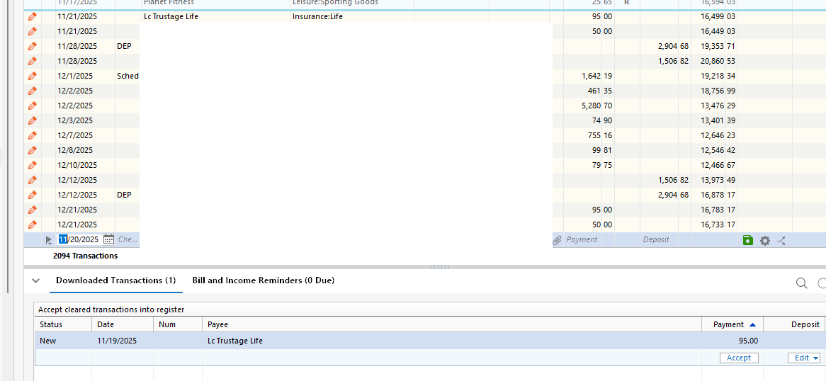

I don't get how Quicken can be so bad at matching transactions. I've downloaded a transaction for $95 with a payee of "Lc Trustage Life" on 11/19. You can't figure out that it matches a transaction I have in my register already for $95, with a payee of "Lc Trustage Life" for two days later, 11/21?!? If I click "Accept" it'll create a duplicate. Please don't be so dense, thx!

Before accepting the downloaded transaction as New, which will create a duplicate, do this:
- Edit the already existing future-dated register transaction (the one dated 11/21) and set date to 11/19.
- The status of the downloaded transaction should have changed from New to Match
- Accept the downloaded transaction.
- Consider changing the Scheduled Reminder, this and all future instances, to an earlier date, e.g., Monthly on the 19th, to avoid this from happening again.
Quicken won't match downloaded transactions to already existing, but future-dated register transactions.
