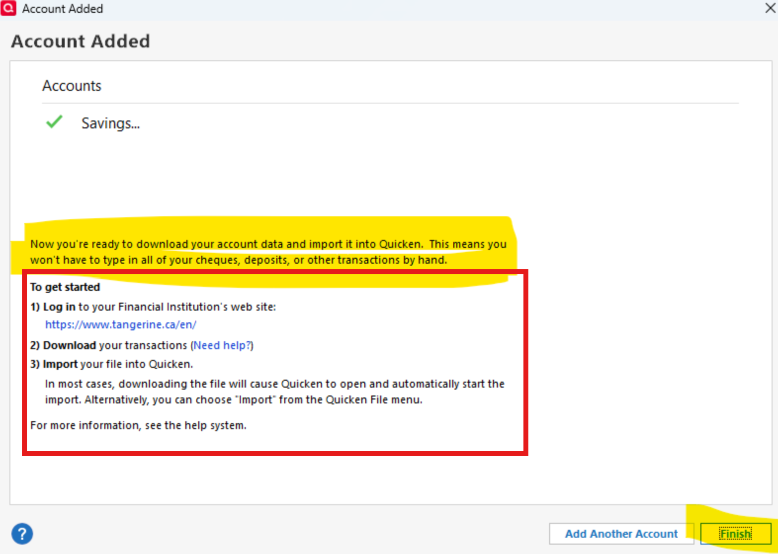

Hello
This is what I get everytime I try to connect for download for certain of my accounts wheter I do it in edit my account or in the set up transaction download button.
@Isa1964 Thank you for sharing the screenshots—they help clarify what’s happening here.
Based on the Step 5 screenshot you posted, it appears you’re trying to connect this account with Tangerine. That explains the behavior you’re seeing.
Tangerine does not support direct online services (Express Web Connect or Direct Connect). Instead, it only supports 2-step download, also known as Web Connect (QFX). Because of that, when you click Set Up Now, Quicken redirects you into the Add Account flow and ultimately creates a new manual account—since there is no direct connection available to link to your existing register.
To download transactions for an existing Tangerine account, you’ll need to use QFX file downloads instead. The instructions you saw in Step 5 are the correct method.

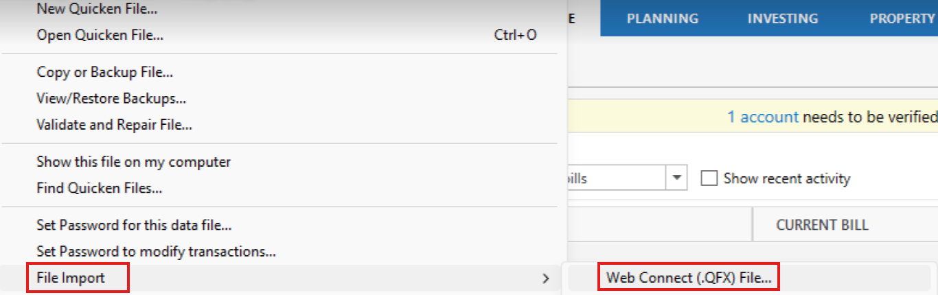

Importing a QFX file into Quicken
- Back up your Quicken Data File.
- Go to the File menu and select File Import → Web Connect (.QFX) File…. The Import .QFX File screen will appear.
- Use the Browse button to find and select the file you want to import.
- Click Open or double-click the file to import.
You can also find these instructions in this Help Article.
