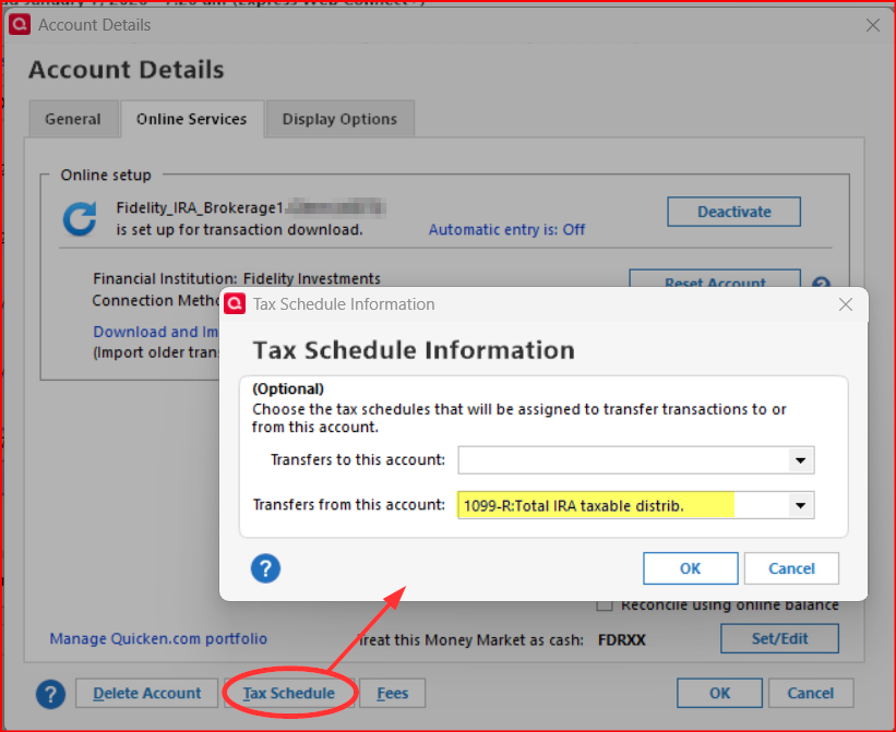

One thing I would add: Go to Account Details for the IRA account and make sure the Tax Schedule for withdrawals is 1099-R:Total IRA taxable distrib.. When setting up IRA accounts it seems the default Tax Schedule for withdrawals tends to be 1099-R:Gross IRA taxable distrib. which will not capture distributions as taxable so you will need to make sure 1099-R:Total IRA taxable distrib. is in that field.

In the IRA, click on the gear at the top right and select Edit account details. Click on Tax Schedule and set Transfers out to "1099-R:Total IRA taxable distrib." If you don’t see the Tax Schedule button at the bottom of the Account Details dialog, click on View in the top menu and select “Tabs to show”. In the list of tabs, select Planning.
