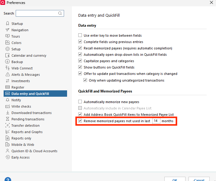

While waiting for the issue to be corrected, there are a couple of ways to bypass the issue.
- You can set Quicken to automatically remove memorized payees that haven't been used in a set time period.
- You can do this by going to Edit>Preferences>Data entry and QuickFill.
- In the QuickFill and Memorized Payees section, select "Remove memorized payees not used in last 'x' months". Fill in the number of months. Then click OK.

0 - You can set Quicken to automatically remove memorized payees that haven't been used in a set time period.
I would like to take advantage of the automatic deletion of entries that have not been used recently, but I generally lock the entries. Locking prevents them from being changed if I edit a downloaded transaction, to change the Category for example.
Unfortunately locking also prevents them from being automatically deleted as described above.

I use the option of deleting memorized payees not used in the last 12 months. It does not seem as thought this option works well as some of my memorized payees were last used in 2021 asper this :
I'll report this as a problem
Are the memorized payees that are not being deleted automatically Locked, i.e with a padlock icon in the Memorized Payee List Lock Lock column? If the Lock column is not shown in the list, click on the Columns icon above the vertical scroll bar and select it.
As noted in my previous post, locking a payee prevents it from being auto-deleted. It has worked that way for a long time and that appears to be the design intent, but I think locking should only prevent the Payee details from changing and not prevent auto-deletion. Maybe there should be a separate "Prevent auto-deletion" setting.
QWin Premier subscription5 -
Jim, You are correct. They are locked. I've now added Lock to my display which will help me keep track. Should I/can I remove report a problem that I submitted for this
