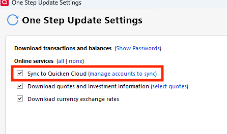

  • Quicken Kristina
    Hello @westolivelisa,
    Thank you for letting us know you're also seeing this issue. To help troubleshoot, please provide more information:
    • When did you first notice this issue?
    • Is this happening only in accounts that sync with the Quicken Cloud?
    • Is your Quicken file set to sync with the cloud when you run One Step Update?
      • If it is, you'll see the option selected in the One Step Update Settings window. Screenshot 2026-04-10 at 5.37.10 PM.png

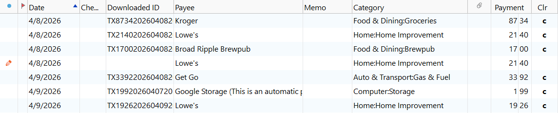

    I'm sorry this is an issue for you also. I've used Quicken as long as I can remember and while there have been a few minor frustrations, the duplicates and also the dates changing on me for recurring income and bills are going to lead up to an end me using this product. They need to fix this. I've already had late fees from missed bills that exceed what I pay for Quicken annually. I'll go back to a custom spreadsheet soon.
    I did do something recently that is helping me search the duplicates. It isn't bullet proof but it certainly helps. If you add the Downloaded ID column to your account (in my case, Checking) it can help you search duplicates. In my example, I have two transactions to Lowe's for $21.40. One is reconciled with a number in the Downloaded ID column while the other does not have anything in that field. I happen to believe the second one is real and just hasn't cleared yet because of a recent home project. So, you still have to do some investigation but seeing a blank in the Downloaded ID column can help point your eyes to what might be duplicates to investigate first. Hope it helps you!
