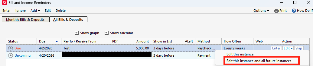

I suggest moving it to the Post-Tax Deduction, as recommended by Minnesota tax guidance. To do this:
- Go to Tools > Manage Bill & Income Reminders.
- In the Manage Bills and Income Reminders window, search for the paycheck and click the Edit button.
- Select Edit this instance and all future instances.

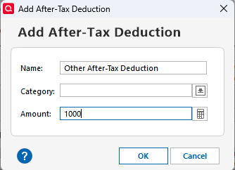

- Scroll down to Add After-Tax Deduction.
- Choose the option that works best for you, enter the amount, and select the appropriate category.
- Click OK to save your changes.
