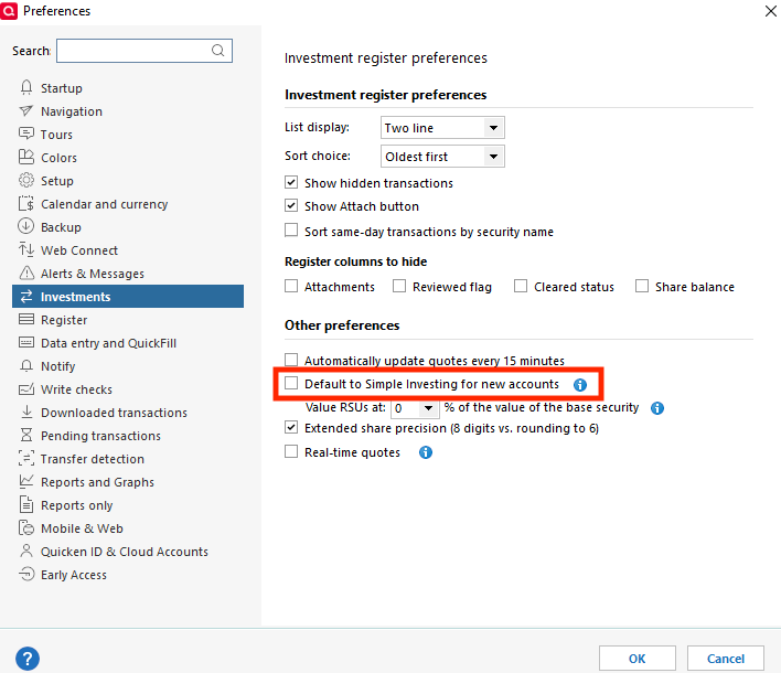

First, could you please navigate to Edit > Preferences > Investments. To see if the setting for "Default to Simple Investing for new accounts" is selected?

It is checked, but I didn't make this change. Was there any instruction sent to users to tell them the new connection method would treat existing accounts as new?

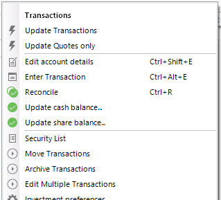

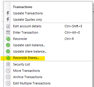

Another issue I am seeing is that the Reconcile Shares option is now missing for the Merrill accounts.

For the issue with the reconcile shares option not showing up anymore, I recommend that you contact Quicken Support directly for further assistance, as they have access to tools that we can't access on the Community, and they're able to escalate as needed. The Quicken Support phone number can be found through this link here. Phone support is available from 5:00 am PT to 5:00 pm PT, Monday through Friday.

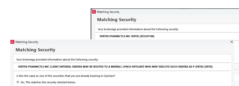

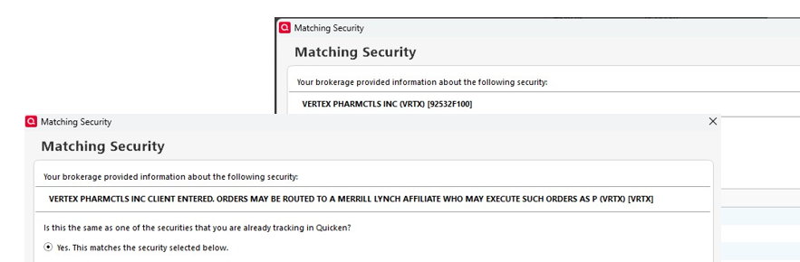

These are IRAs. Today it asked me twice about 2 securities and some others where there was activity. For the 2 securities it asked me this morning and again this evening. The brokerage information (name) provided is different for STAA and VRTX. Example below:

Ok - Not possible to report the problem when the "Matching Security" window is displayed, but I'll take a screenshot.
