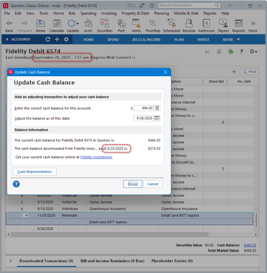

I noticed that for today's download on 9/26/2025, Quicken reports the cash balance for 9/25/2025 for all accounts. It seems that Quicken (or Fidelity) is not reporting the latest cash balance as of the download date. It seems to be a day behind. Is this normal? I tried the DC connection with my alternate datafile and it brought in the correct cash balance as of 9/26/2025.
Deluxe R65.17, Windows 11 Pro

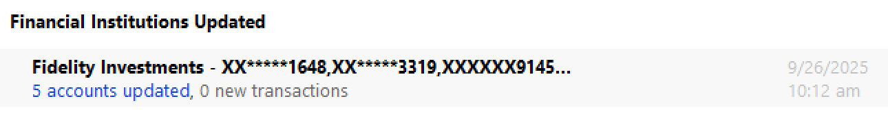

I went with reset account 3 times already, but no expected Sept 24 transactions are downloaded

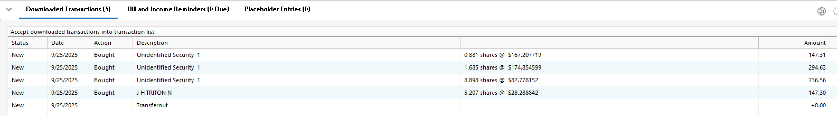

And for another Fidelity login, my wife, I got new download with 5 transactions, but Unspecified security are there.
