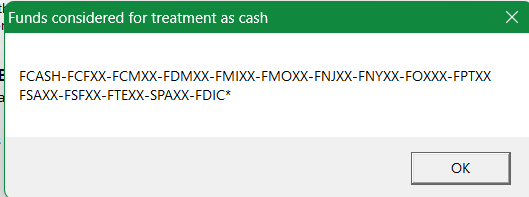

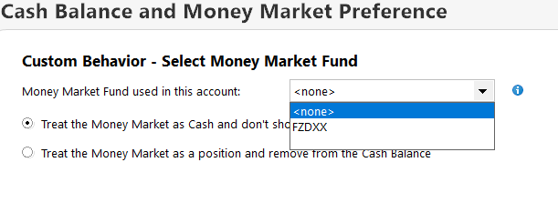

I still have the problem with FDRXX after upgrading to R65.17. In the Online Services window it says "Treat this Money Market as Cash: none". When I click Set/Edit, and look at the list of funds, FDRXX is not in the list. When I click Customize, FDRXX is not in the dropdown list. Only FZDXX is which is another MM account but this is not my cash account.

Sorry Anja. Typos. I corrected my original comment. Here are some screen shots.
This happens with all 4 IRA accounts. The 3 brokerage accounts are good.
@Tom-R Thanks for the follow-up and for providing the screenshots.
You can try reinstalling the latest update patch for R65.17 here to ensure it is installed correctly.
If the problem persists after reinstalling, we recommend reaching out to Quicken Support directly so they can log it and investigate further.

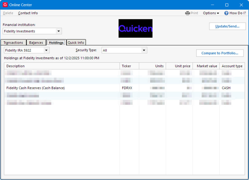

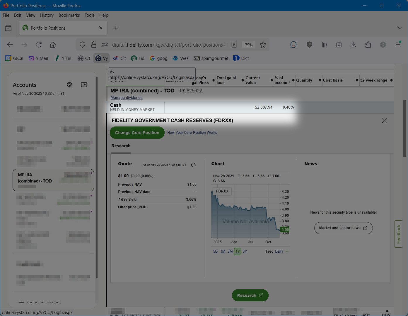

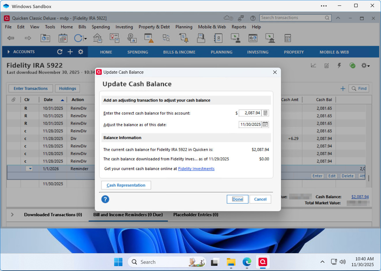

@Quicken Anja The issues with FDRXX as the core position seem mostly but not completely resolved. Quicken still reports a downloaded Fidelity cash balance of $0.00 even though the Fidelity website shows the cash balance is the value matching FDRXX. In the example below, Quickens shows the downloaded Fidelity cash balance is $0.00. However, the Fidelity website shows the cash balance is $2087.94 which matches the value of core position FDRXX. I'm using Quicken R65.17 in a Windows Sandbox. The Online Center in Quicken states that FDRXX is the (cash balance) with a value of $2087.94 and that Available Cash is $2087.94. So it seems Quicken is reporting the incorrect cash balance amount downloaded from Fidelity or is not setting the downloaded value of FDRXX to be used as the "The cash balance downloaded from Fidelity Invest…".
From the Fidelity website:

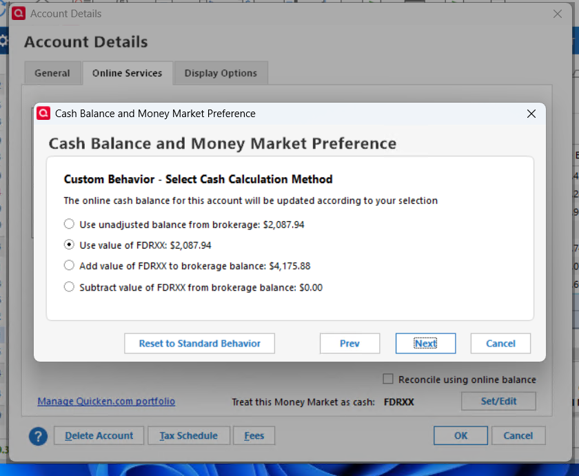

In fact, Quicken seems to "know" the downloaded value from Fidelity is $2087.94 as indicated by the "use unadjusted balance from brokerage: $2,087.94". So it may just be a cosmetic correction in Quicken to have it report the correct downloaded Fidelity cash balance for FDRXX. Just guessing.

Hello, Yes, still have issues with Fidelity FDRXX in at least 2 account. Currently using Quicken Business & Personal, R65.17, Build 27.1.65.17. (Quicken user since the early 1990's) I'm not finding the screens shown in the Nov 30 post where there's apparently an option to 'select the cash calculation method'?
So my questions are: 1) Am I correct in understanding that the supposed 'fix' has been completed for all users, and thus I'll now need to contact Quicken Support? and 2) Am I correct that I will be able to choose to track FDRXX as a cash position, equivalent to how it appears in the positions on the Fidelity website (vs Quicken still shows Fidelity reported cash as zero, same as the previous screenshots)?
I have the same issue as the above that shows current cash balance in quicken and shows the cash balance downloaded from fidelity as zero. accounts FDRXX, FZFXX. SPAXX shows same dollar amount for quicken and Fidelity download.

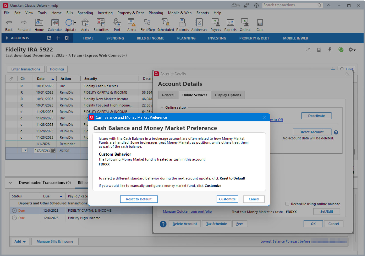

@PK2K Once I updated to R65.17, here is what I did to set FDRXX as the cash core position. I used Customize in the In Set/Edit in the Account Details window and selected FDRXX as the fund to use as the core cash position.
Although the Investment Register incorrectly shows the value downloaded from Fidelity as $0.00 (reported as a bug), the Online Center correctly shows FDRXX is used as the Cash Balance and has the correct downloaded value.
Hope this helps.
Deluxe R65.17, Windows 11 Pro
