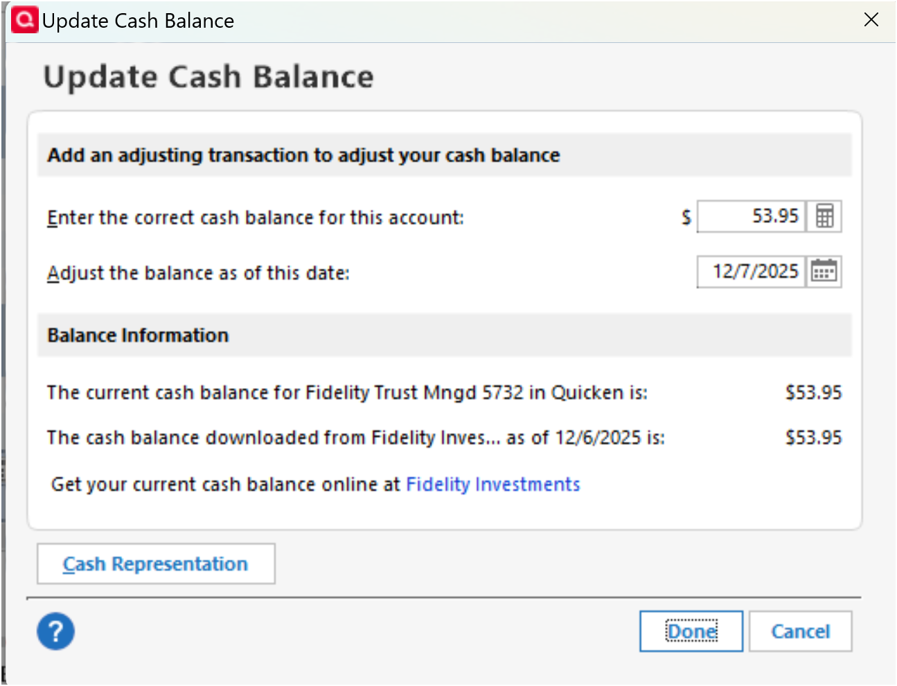

Below is what I think all accounts using a cash security should show. Only one Fidelity and one Schwab account show the button.
CAUTION: If you accept the setup to handle cash, it's followed by the option to delete all buys and sells. Make sure you have backup as when I accepted it, Quicken changed and added transactions with transfers between accounts. It took many hours to correct.
There are many issues with Fidelity. For each month's reconciliation, I have to download from their website the transactions and holding and match them to corresponding exports from Quicken in spreadsheets. Schwab continues to download buys and sells which I have to delete every day there's a trade. It has done this for about 5-years; ever since they updated their connection issue
show "Update Cash Balance." Notice the button "
