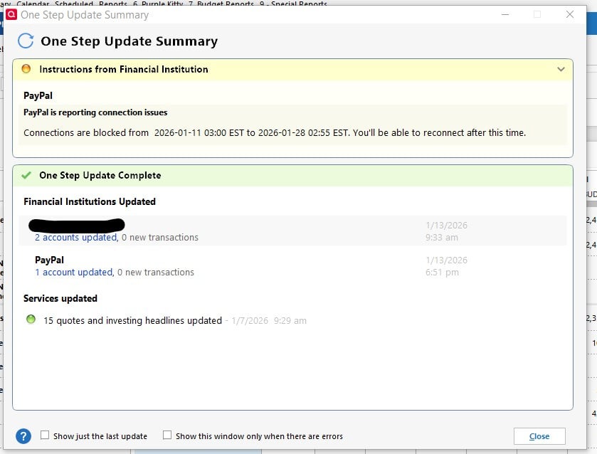

Is anyone else getting this message during OSU?
Does anyone know why?
UPDATE: I have 3 different PayPal accounts. Now when I try to log into them I am prompted to create new PWs but when I change the PW for one account it doesn't change it. Instead it changes the PW for one of the other accounts. There does not seem to be any pattern to it. Really odd.

    I just ran OSU, again.
    • Account #1: Updated and downloaded a transaction correctly but I still got the message stating that PayPal is blocking connections. image.png
    • Account #2: Appears to have updated correctly but there were no new transactions to download so I cannot confirm this. I still got the message that PayPal is blocking connections.
    • Account #3: I was prompted to reauthorize but the reauthorization could not be completed because PayPal.com would not recognize the UserID nor the PW. I have tried logging into PayPal.com on 3 different browsers and both gotten the same result. I tried to reset the login information on PayPal.com and it is asking to answer security questions that I do not recognize. (Yes, I have requested a call from PayPal regarding this.) image.png
    So, for me the situation has changed some but there is still that message that PayPal is blocking connections.

    Quicken claims that the provider is blocking Quicken. There has been no details or notice of these blockages. I can't reach PayPal but SoFi says that it's a Quicken problem not something on their end. Will this be another endless finger pointing connection issue?

    I just ran a one step update and both PayPal and SoFi give the same announcement.
  • jordanal
    jordanal Quicken Windows Subscription Member ✭✭✭
    Getting same OSU PayPal message this week. Re-activating the online account has no effect.

    Me too. PayPal Update gives this message:
    "PayPal is reporting connection issues.
    Connections are blocked from 2026-01-11 03:00 EST to 2026-01-25 02:55 EST. You'll be able to reconnect after this time."
    Download to Quicken has worked flawlessly for years prior to this. Any advice what I can do to download transactions?

    Deactivate the PayPal account and Set Up Now - again in Online Services did not fix the message. After deactivating when I did the 'set up account', it prompted to login to PayPal on the browser and authorize. I did. The browser said Quicken authorized. Quicken prompted to "Link to existing account" as expected and said downloaded last 90 days of transactions.
    However, when I close and then do "One Step Update", it still returns the message that PayPal "Connections are blocked from 2026-01-11 03:00 EST to 2026-01-28 02:55 EST. You'll be able to reconnect after this time." And in the Update Summary it says PayPal - '1 account updated, 0 new transactions' but the connection issue message persists.

    Same good results for me today. In 3 different data files, each with a unique PayPal account, this message of PayPal blocking the connection was not present in the OSU Summary Reports.
  • Glen Dais
    Glen Dais Quicken Windows Subscription Member ✭✭
    No longer getting the "Connections are blocked…" message after One Step Update on PayPal. Seems to have corrected itself.
