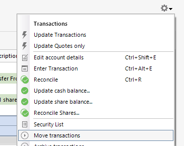

  • UKR
    Instead of
    • Copy all the transactions out of the old version of the Discover account, paste them into the new version of the Discover account. (Yow! The checking account out of which all my Discover account payments get made went way in the hole! Because payments are doubled now — one to each version of the Discover account. That's kinda funny. I've really spent that much on credit card purchases?!?)
    • Delete all the transactions from the old version of the Discover account. (Phew. Checking account balance normal again.)
    I would suggest to do this instead:
    • Block-select all reconciled transactions in the old account register. Mark them as "cleared". (I'll explain why later)
    • Block-select all transactions in the old account register except the Opening Balance transaction.
    • Right-click on a selected transaction and pick "Move transactions" from the popup. Select the new account register as the destination of the move.
    • When Move is complete, go to new register. Block-select all "cleared" transactions and mark them "Reconciled" again.
    • Change all Scheduled Reminders using the old account to use the new account instead.
    • Your old account register should now be empty except for the Opening Balance transaction. If you have updated all Reminders, go ahead and delete the old account.
    Moving transactions will correctly adjust the from/to-account categories in transfer transactions. That means you don't have to fix up the other side of transfer transactions and delete duplicates.
    The "Move transactions" process will prompt you for every single reconciled transaction if it's OK to move this transaction. Marking transactions as not reconciled (i.e., cleared) before move prevents that chore.
