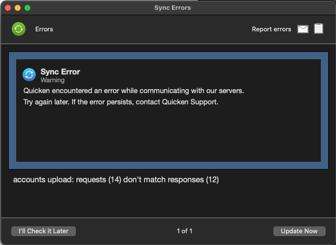

    Yesterday I updated from Quicken Classic Premier version 8.3.1 to 8.4.2. I immediately started to received a Sync Error pop-up message (screenshot below).
    Like some others, I have always had Mobile & Web Sync turned to Off. But, per some of the comments above, turning Sync to On and then back to Off seems to have fixed the problem. Here is exactly what I did to fix the Sync Error pop-up message:
    1. Click on Quicken > Settings > Mobile, Web & Alerts.
    2. Turn Sync to On. Quicken took two or three minutes to update the setting, so I was patient and let it finish.
    3. Turn Sync to Off.
    4. Close Quicken Settings window.
    5. Now, updating/syncing my accounts (by clicking circular arrows icon) does not give me an error message. And my accounts are syncing normally.

  • jacobs
    I turned it on and then back off. I hope all my data does not now reside on some server!
    You could go to Setteings > Connected Services and click the cloud Reset button. That would delete the existing cloud file and create a new one — and as long as Sync is off, the new cloud file won't have any of your transaction data or account credentials.
