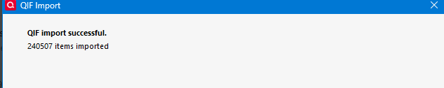

My process goes like this.
Do a QIF export, selecting all the options.
Create a new data file with cloud sync off and when asked to add an account just cancel it. Then go in and delete all categories (so that you don't have to deal with the default ones they create).
Drop QIF file on ChangeTransfers.exe which creates DATA_FILE_NAMEXfrsAsCategories.QIF
Import that QIF file selecting all the options (the "use special handling for transfers" doesn't matter because there aren't any transfers).
Wait (it takes a long time to do the import especially since the stock quotes are really slow to import). And that reminds me on one prep that needs to be done. Quicken will not import any security prices for securities that don't have a security symbol, and some securities naturally don't have security symbols. So, make sure you add one before you do the export. Something like this works fine _MySec.
In the case of Quicken Subscription where it the transactions go right into the register you don't even have to "accept" anything. About the only prompt is to it asks to create new categories/tags. In the case of Quicken 2017 and below you have to go through each account and do an "Accept All".
Note that all your hidden accounts and such will lose those settings. In Quicken Subscription this isn't too bad since you can go to the Manage Hidden Accounts menu/window and change them there, but for Quicken 2017 and below you are going to have to go into every Account Details → Display tab.
Also, since you can't have different versions of Quicken on the same machine, for different versions of Quicken I would use different machines for the conversion so that you can still look at the old data file. Trying to remember all the possible things that might not get transferred seems prone to missing something.
Which BTW if you are trying to do the matching of transfers it can be very frightening since the balances don't have a chance to being right until all the accounts/transactions have been accepted.
I just tried it for my data file.
I certainly haven't gone into details, and the current total balance is certainly not proof that everything is correct, but I did get "pretty close" with a difference of $-4,122.91.
Once I hide all the old accounts then this showed:
Expanding out:
Not surprising, I remember that the Options account had a problem where for some reason 4 shares where not accounted for. And not sure about the cash remaining in the E*Trade account, but a balance adjustment there to remove it is easy.
And with that my current balances all look good, and the same for a net worth report for all the years I have been using Quicken.
I believe that @splasher didn't have the same luck where he had more problems with the investment accounts and decided just to not deal with them in the Quicken 2013 data file.
You also have to watch out for the fact that securities are no longer hidden and that all of them are selected for downloading.
Signature:
This is my website (ImportQIF is free to use):1 -
Just tried reconnecting one account for online service in the new data file. It looks like to make that work right you definitely need to turn off automatic transaction entry mode and delete all the "new/matching" transactions that come in.
This of course, only relates to doing this in Quicken Subscription.
Also, the resulting data file is about 1/3 the size of the original. I believe I have done this in the past and it quickly grows when you start downloading transactions again.
