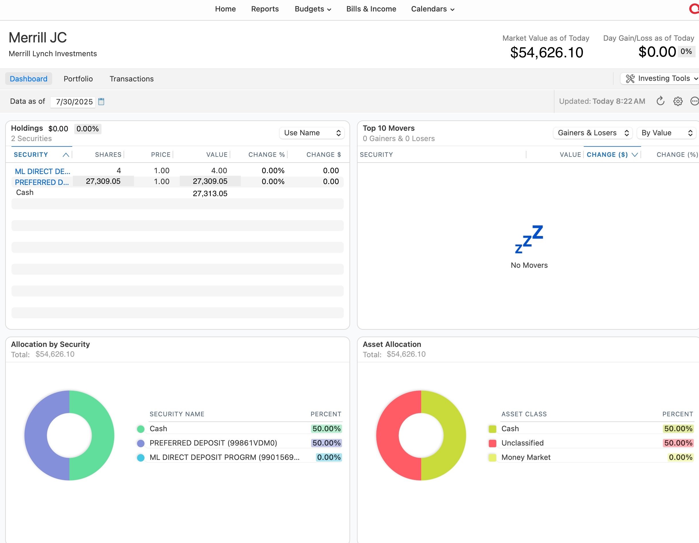

In Transactions the Balance is correct. On my dashboard, in Holdings the Security Value is correct (which happens to be a cash-type security, a Preferred Deposit) so the total Cash is the same as the Security. However, in the dashboard, the Allocation by Security and the Asset Allocation both show a Total that is double the Holdings with Cash showing 50% and the Preferred Deposit showing 50%.
How can I fix this?

Thanks for the detailed explanation! Could you share a couple of screenshots showing what you're seeing on the dashboard—specifically the Holdings section, Allocation by Security, and Asset Allocation? That’ll help us better visualize the issue and guide you more accurately.
And no worries about posting here — your question is related, so it’s totally fine for now. If it turns out to be a different root cause, we can branch it off later if needed.
I've edited the amounts for the sake of privacy but here's a screenshot of the dashboard showing what I'm saying. Under Holdings, the amount is correct and matches the register balance (27,309.05) but notice how the value is doubled in both Allocation by Security, Asset Allocation (and Market Value as of Today).

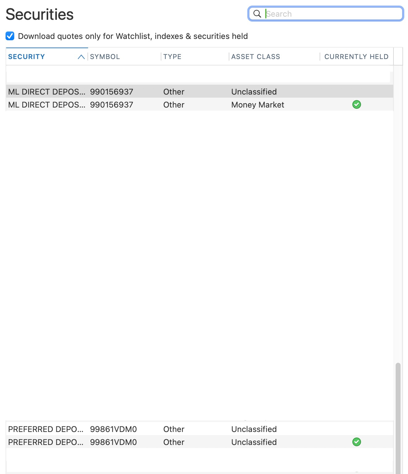

I followed those instructions and under Securities I found entries for Merrill Lynch next to each other that might be duplicates. I merged them and nothing changed so I undid the Merge. Everything in the dashboard was the same as I reported.
Of these Securities (which appear on the dashboard), I first merged the two ML DIRECT DEPOS… securities, then I merged the two PREFERRED DEPO… securities. Neither of those merges changed the values on the dashboard. Then I merged all four securities and that didn't change the values on the dashboard either. That's when I did an Undo Merge for all.

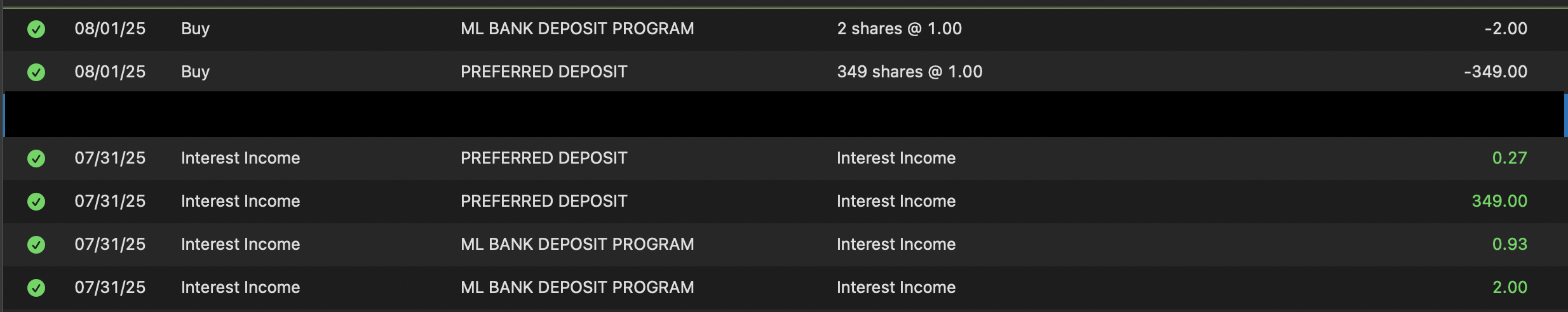

What I have noticed in trying to untangle this mess is that prior to EWC+ ML money market funds (e.g. ML Bank Deposit Program and Preferred Deposit - both of these are used in taxable ML brokerage accounts; and Bank of America NA RASP and BLF Treasury Trust - these are used in ML Retirement accounts) were treated as piles of money but not as funds that had to be purchased in discrete share lots. I think that this is where some of the discrepancy in the account balance is coming from. The reason it is so large is because the change to EWC+ has covered a long period of time during which direct connect was the standard and money market purchases were not treated as "shares" purchased.
Receive interest or dividend —> $ swept into cash —> whole dollar amount transferred to one of the money market funds noted above —> shares of that money market fund purchased. This is a 3 step process which direct connect did not account for and now that EWC+ is the download protocol the unaccounted shares are showing up but not seen in Quicken. In the screen shot below I have added two transactions seen at the top, "buying" the whole dollar amount of the interest received. In looking at the ML website this is how money is accounted for, dividend/interest received —> whole dollar shares of money market fund purchased.

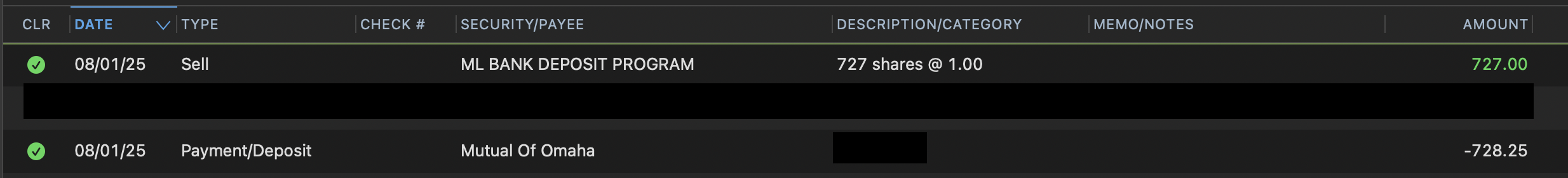

When brokerage account (non-retirement) is used to pay a bill, money has to be manually moved from the ML BANK DEPOSIT PROGRAM (in this case) to cash by selling shares of the ML BANK DEPOSIT PROGRAM. I was only able to figure out how many shares to sell by the amount of discrepancy in the Quicken reconciliation window. But it worked. The difference in the amount of shares sold compared to the amount paid out is due to an unseen cash balance in the account.
Unfortunately even the ML web page display for activity in this account does not reflect this two step process.
