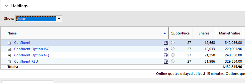

Why don't you post a picture of the "Holding's" in that Account to show us? Blank out the name of the Company if you wish, but as far as I can tell "robkunz1" could be my next door neighbor or live in China.
As you see, the math is wrong.

Is the market value of the options reduced by the strike price?

What’s the market value of 100 shares of an NQSO currently trading at $20/sh with an exercise price of $15/sh? It’s $500 not $2000.
