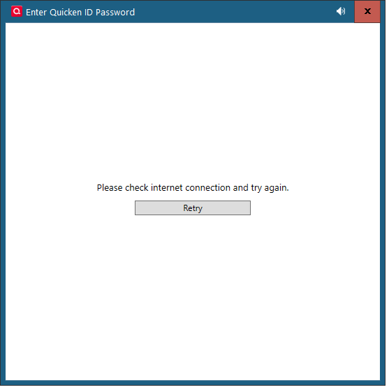

This morning I installed R64.23 update and after the installation I can't do much in the system. When I try to do any meaningful action such as One Step Update, I would get a dialog to enter my Quicken ID Password. After I click Continue I get Please check internet connection and try again (needless to say I'm connected all this time). Clicking Retry does nothing and then when I try to close this dialog the system crashes (I did sent the Quicken Crash Report to the Quicken team). What can I do to make this work?

I have the same problem after the R64.23 update. A dialogue titled "Enter Quicken ID Password", that is blank for about 20 seconds and then gets "Please check internet connection and try again". Everything else on my computer is working fine on the internet.

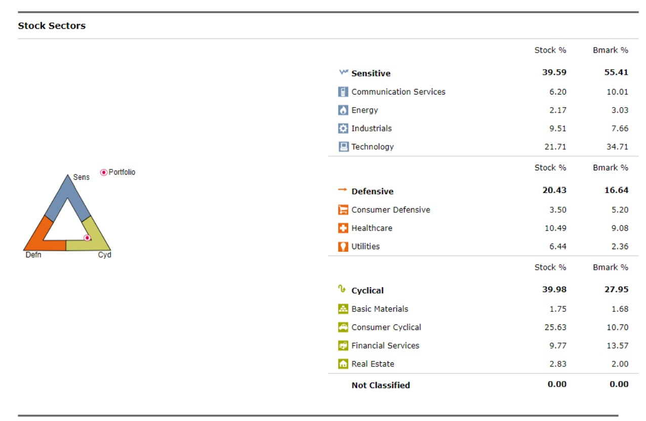

I installed 64.23 this morning and the bug I noticed is in the graph display in the X-Ray interpreter. The dot point is stuck in the edge of the triangle, where it should not be. It was always more centered based on the same numbers.

Below is the dialog with the error. Also, contrary to what someone else said, I got the same error when going to preferences and attempting to change my quicken id.
Thanks for sharing the screenshot, @captiveuser.
Does this pop-up allow you to close it? If so, it may keep appearing repeatedly during the sign out/sign in process. In that case, you’ll need to continue closing it each time it pops up until you reach the full sign-in screen. I know it’s a bit annoying, but once you complete the sign-in, this pop-up should stop appearing.
This is the same one I'm getting
I can close it, but the problem for me is that after I do that Quicken crashes and shows the standard dialog asking to send report to Quicken
I can also close the Enter Quicken ID dialog multiple times, get to the sign in dialog, and open my Quicken file, but as soon as I try to do anything, the same dialog comes back. Also, trying to create a new Quicken file or going through Preferences to enter a Quicken ID get the same dialog/error.

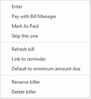

If I play around in Billers tab, I get frequent crashes.
Sent several crash and problem reports
Hello @miklk,
Thank you for letting us know you're getting frequent crashes on the Billers tab. Have you noticed anything specific triggering the crashes? If not, is there any pattern to when it crashes?
I look forward to your reply!
Of course, I tried to reproduce now in several datafiles and it did not crash with multiple menu items clicked.. Earlier, I was working in my files trying to get rid of erroneous Bill dates and amounts on Billers that showed the next due date with the prior months amounts. I was only using the menu where it usually starts under the Quickpay mostly unlinking to reminders, default to Total and then skip a bill. (Maybe not crashing now because all bills now just awaiting next bill due to the work I did earlier.)
