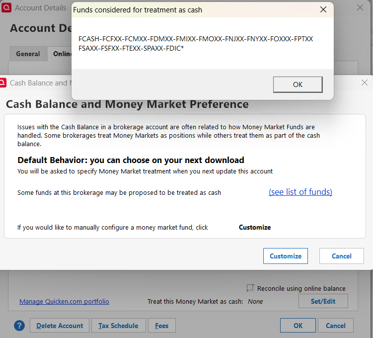

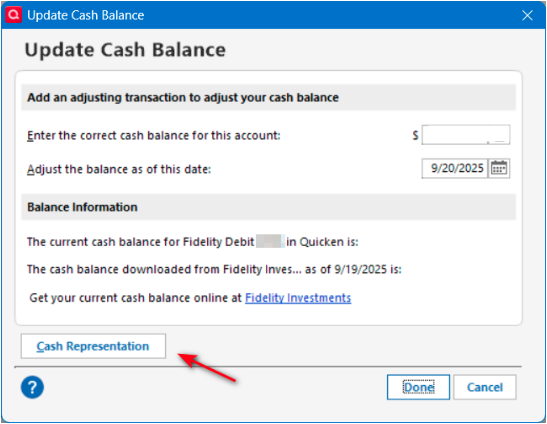

Thank you for reaching out! There have been some posts about the cash balance still being represented incorrectly when transitioning to the new connection method, however, those issues have been reported and many have been fixed. To help troubleshoot this issue, please provide more information. Which fund is being incorrectly interpreted as cash? Which fund should Quicken be seeing as cash? Does resetting the money market securities/cash options correct the issue?

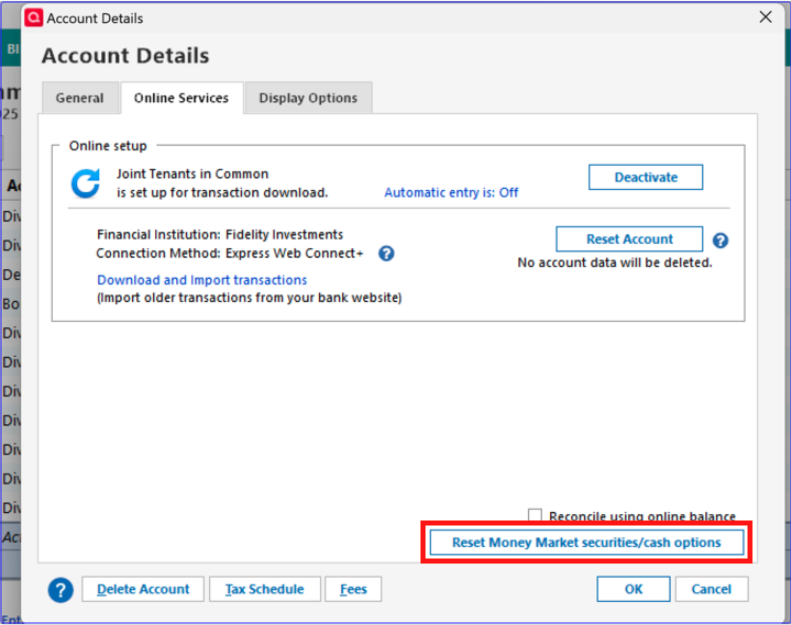

To reset the money market securities/cash options, if the option is supported for the problem accounts, you should be able to navigate to Tools>Account List, click the Edit button next to the problem account, and in the Account Details window, Online Services tab, you should see a button that will let you reset money market securities/cash options.
You may also see the option if you click on the blue cash balance near the lower right of the problem investment account register.

The buttons for resetting money market/cash options are not available in either of the options you suggest.

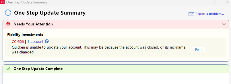

To troubleshoot the CC-506 errors, please follow the troubleshooting steps in the article linked below:

I have sent the problem report. As for the CC506 error, it was fixed using the suggested instruction of de-activating and re-activating the Fidelity accounts. Thanks!

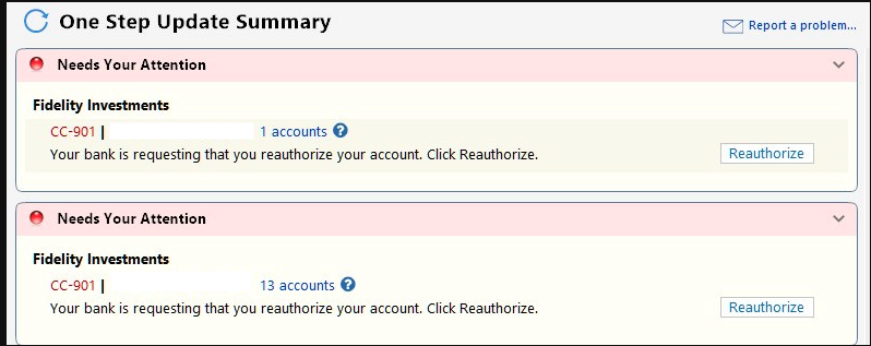

Initially I tried to download all accounts (screenshot 1). Quicken told me I needed to reauthorize all 14 of my Fidelity accounts (screenshot 2). Initially I decided not to reauthorize. I knew one of my other accounts (Chase) had a transaction yesterday, and that did not download and there was no error message. I returned to the download screen and the checkmarks next to all of my non fidelity accounts were gone (screenshot 3).
Next I attempted to download only the Chase account and that was successful. I then tried to download all of the non Fidelity accounts. There were no new transactions in those accounts, but everything worked normally.
Next I went back to try to download just the Fidelity accounts. Before I get into the details, the first 3 screenshots show two entries for Fidelity. The first contains one account. The second contains the remaining 13 accounts. This happened the other day when at the advice of Quicken Support I attempted to deactivate and reactivate the single account. While that process worked, the one account now appears separate from the rest.

When I attempted to download just the Fidelity accounts I was once again told I needed to reauthorize (screenshot 4). I clicked on the button, went through all of the Fidelity authorization process (even though all of the accounts were marked as authorized on the Fidelity site) and eventually I got a successful authorization message from Fidelity (screenshot 5). I closed that browser window as I have never been automatically redirected to Quicken. I then needed to wait for almost 10 minutes (screenshot 6). Finally success (screenshot 7). Quicken then told me that the 13 accounts were successfully updated, but I still needed to reauthorize the single account (screenshot 8). I had to do this even though I authorized that account in the previous step. This is one downside of having two separate Fidelity entries that I described above. I would love to fix this.
I the went through the exact same reauthorization process again. The first time when I returned to Quicken I received an error message (screenshot 8), indicating the sign in failed. I did not understand the message because I successfully signed it, navigated through the Fidelity web pages, made sure the accounts were checked and received the same success message (screenshot 5) that I did before. So I went through the process again and this time it worked. Now all my Fidelity accounts were authorized, but no transactions had been downloaded yet.

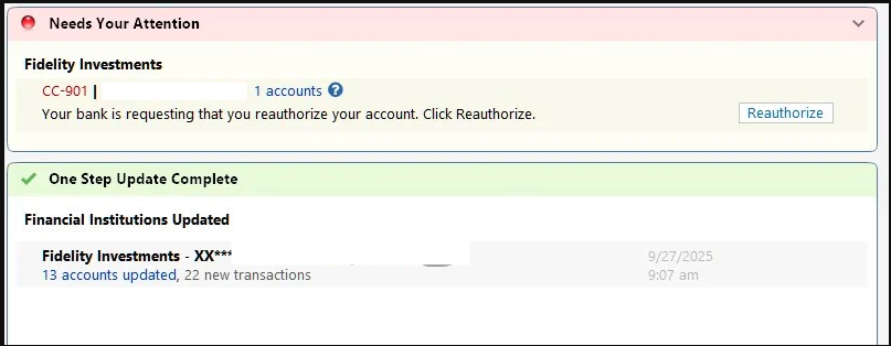

I once again attempted to download the Fidelity accounts. This time it worked with a couple of issues.
- Once again a lot of old transactions were downloaded. But the transactions were different than before. For the two accounts with the largest number of transactions, only yesterday's transactions were downloaded. For other accounts, old transactions went back as far as June 30. In previous attempts, I never saw transactions older than a month. I manually deleted almost all of the 121 transactions. This time I had to be careful because there were a valid transactions from yesterday.

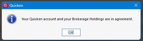

- For all of the accounts with cash in FDRXX I continue to get a securities comparison mismatch screen see screenshot 10 for an example. the "Shares Reported" amount matches the cash balance in quicken. See screenshots 11 for an example of what you see if you click on details. I believe @Waitingtoretire and I are seeing the same behavior.

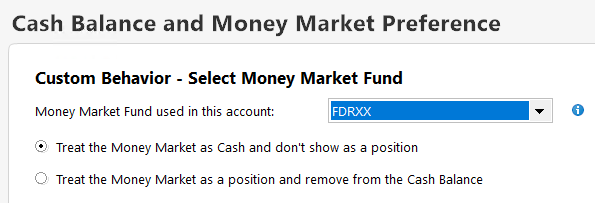

The most recent update, R64.30, should have made the reset cash representation option available in more Fidelity accounts. If you haven't already done so, please try following this process from the Community Alert on the change to how Money Market Funds/Cash are represented with Fidelity:
Quicken Windows users may need to change the Money Market representation if they are not prompted. You can do this by clicking the Cash link in the account or in the Account Details>Online Services Tab, the “Reset Money market securities/cash options to trigger the choice of cash or security again. The cash balance will still be the same that Fidelity reported for the one or more money market securities they have.

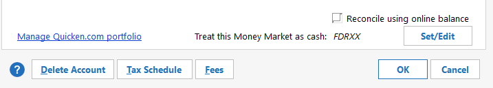

Nope! Although the connection is Express Web Connect +, the accounts with FDRXX as the core money market is still not representing it as cash, and the option for resetting money market securities / cash is not available.
3 -
Since the instructions in the alert did not resolve the issue, I recommend that you contact Quicken Support directly for further assistance, as they have access to tools we can't access on the Community and they're able to escalate the issue as needed. The Quicken Support phone number can be found through this link here. Phone support is available from 5:00 am PT to 5:00 pm PT, Monday through Friday.

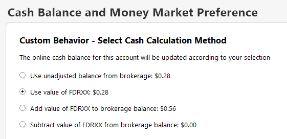

@Waitingtoretire I am in the same boat as you and @leishirsute. I am running R64.30 with an EWC+ connection to Fidelity. My problem account is a Fidelity HSA account which is set up as a Roth IRA in Quicken.
Under Direct Connect and with EWC+ before updating to R64.30, the account had zero shares of FDRXX and my Core account balance was shown as Cash in the Quicken account. FDRXX transactions downloaded as Divs and added to the account's Cash balance.
I updated to R64.30 on 9/26. Starting then, Quicken showed a Securities Comparison Mismatch, with zero shares of FDRXX in Quicken and my cash balance in FDRXX shares at Fidelity. If I clicked on the gear menu and selected Adjust Cash Balance, it showed the downloaded cash balance as zero and the Core account balance as Quicken's Cash balance. In other words, the downloads from Fidelity were showing the Core account balance as shares of FDRXX and the cash balance as zero. There is no option to change the cash representation.
I corrected these mismatches by manually entering a Bought transaction for FDRXX equal to the account's cash balance. This reduced the account's cash balance to zero and made the FDRXX balance equal to the balance reported by Fidelity. Of course that is not the way it has been shown historically, but I will live with that until there is an option to change the cash representation.

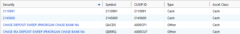

Watch this in my Chase account (which is working properly):
I put in this transaction:
So, one would expect if I did the share comparison I would get an imbalance.
Doesn't happen, because Quicken knows to ignore this security in the comparison.
And that goes for this one too:
Another one Chase uses is US DOLLAR. Looking at all of these the Asset class is Cash (Cash or Other is used for the type).
Looking through the Cloud Sync log it is interest to see how these are coded. The security type is "OTHER" for the QDERQ security (which is in fact an internal account that Chase never shows on their website except as a memo in the transferring of money around). But what is surprising is the CUSIP (the "name" part).
{"resources":[{"id":"[Removed]","createdAt":"2025-09-15T21:00:18Z","modifiedAt":"2025-09-18T06:22:41Z","dbVersion":8,"ownerId":"[Removed]","securityId":"A000CU7","securityIdType":"CUSIP","name":"CHASE IRA DEPOSIT SWEEP JPMORGAN CHASE BANK NA","symbol":"QDERQ","securityType":"OTHER","currentUnitPrice":1.00000000,"currentUnitPriceDate":"2025-09-16T12:00:00Z"}
Here what an actual security looks like:
{"resources":[{"id":"[Removed]","createdAt":"2025-09-17T19:03:41Z","modifiedAt":"2025-09-17T19:03:41Z","dbVersion":0,"accountId":"[Removed]","symbol":"VUSXX","securityName":"VANGUARD TREASURY MONEY MARKET FUND INVESTOR SHARES","quantity":12.300000000000000000,"marketValue":12.3000,"currentPrice":1.000000000000000000,"currentPriceAt":"2025-09-16T12:00:00Z","securityId":"921932109","securityIdType":"CUSIP","localSecurityId":"503556088385856513"}
The bottom line is that Chase isn't doing what Fidelity is doing. It isn't sweeping the cash in and out of a security, it is sweeping it in and out of different internal accounts.
