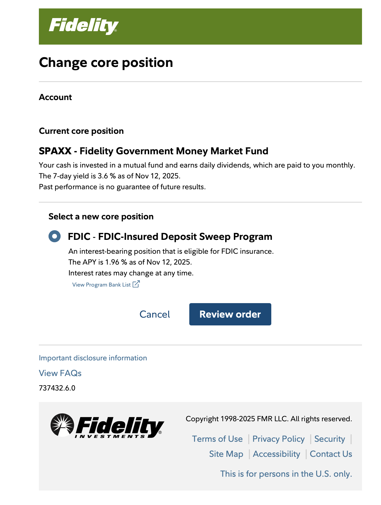

    For my Cash Management account, Fidelity only offers SPAXX or FDIC as options for the Core position.
