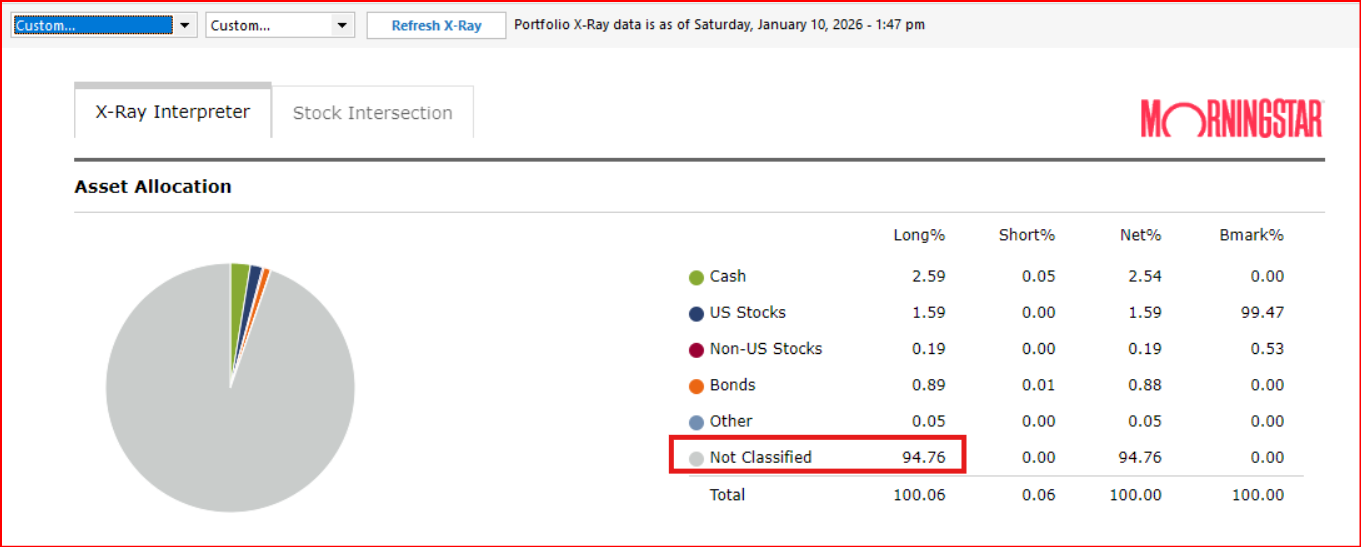

It used to work correctly until a few days ago, maybe a week. Now it categorizes VTI, VOO and VIG as "Not Classified". Stock Intersection is now empty. Please fix this. See attached image.

    Yes, there does appear to be a problem with X-Ray. Mine is worse than yours and I needed to Refresh X-Ray, then select all Securities and then select All Accounts (which afterward shows "Custom…" for both) and got the following picture. Then when I looked at Stock Intersection I noticed that most of the securities I hold are not listed.:
    If you want Quicken to investigate and fix this please report it to Quicken via Help > Report a problem. That is the best way to make sure they are aware of this issue. They will need to determine if this is a Quicken cause or if it is a Morningstar cause.
    I have already reported this issue. The more people who report it the higher the priority will become for the Quicken Team to address it so please do report it.
