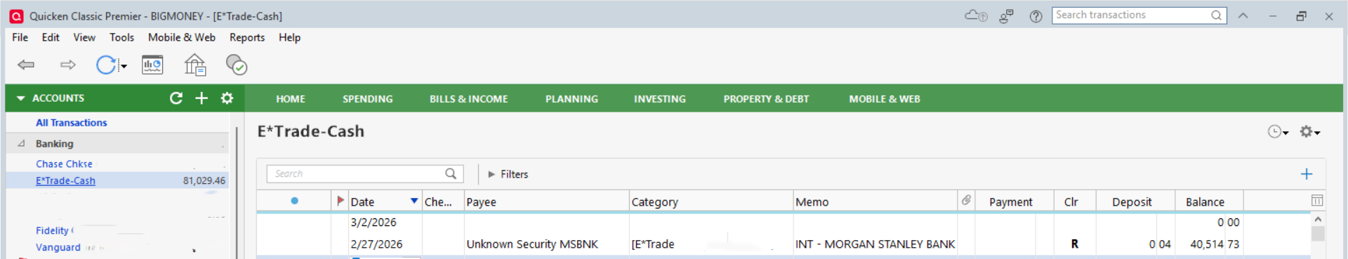

I'm seeing something very similar to what KnnNike wrote about in April here:
In my case, it's an etrade linked cash account and the account bar is showing an exact doubling of the true balance shown in the register. I also compared the account balance with the net worth reports that Jim_Harman recommended checking for comparison. All the reports matched the register value. The other difference from KnnNike is the total banking balance is not correct. It's using the wrong balance in the sum.
Here's a screen shot (with current date at the top to make it easier to hide other account info. I don't know why sorting with the newest date at the top inserts a blank transaction with a $0 balance).
The previous thread has been closed without any resolution posted. Does anyone have any suggestions?

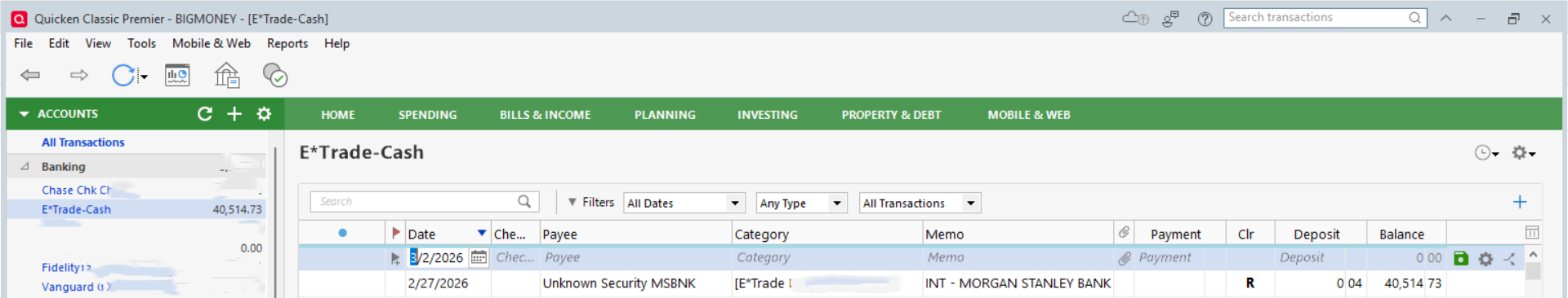

Update after drafting and prior to posting this whole thing, I ran "validate file", with no fix but then ran "super validate file" and… It's fixed! Hope it works for you if you have this issue.
Here's the screen shot showing the fix.
