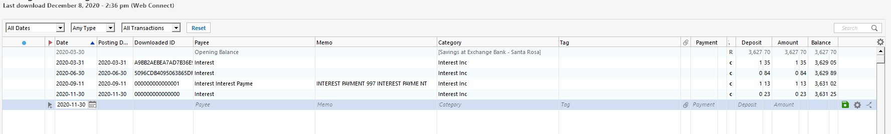

The downloaded transaction from the Exchange bank .qfx for an <TRNTYPE>CREDIT are not showing in the transaction window.
I found this when I started reconciling the last 6months of a savings account.
I've had to manually enter the last three months of interest ~ but hadn't had problems before that. (Exchange bank upgraded their software earlier this year, and been modifying the <NAME> field to be more meaningful in other account types)
Enclose the register Snip.jpg of the last 4 transactions
Just downloading the interest payments to .QFX and looking at in a text editor (via https://jsonformatter.org/xml-pretty-print) the XLM I see that for the last 3months <FITID> is not changed.
<FITID>000000000000000</FITID>
Could this be causing Quicken to reject them on download.?
(snippet of .qfx shown below - the Preview shows all indents taken out - but I've pasted it looking pretty)

Hello thanks for the response. The version is 2020 R20.10 27.130.10 - just renewed.
On doing the test as described above, brand new Qtest2012.QDF - response is the same.
I'm on Windows10 and for a downloaded qfx from Ex bank its automatically imported to the new Qtest2012.
Setting up an Exchange bank filter field to only download Interest for this year - 6 entries, when downloaded to Quicken, only 4 entries are imported.
Enclosed jpg snapshots, pretty-pretty qfx as pdf (won't allow .txt)
Two download entries dropped, no visible error code in the download that I can see off. Just missing entries.
The downloaded I accepted into the register, and then made the Posting Date and Download ID visible.
Should I be reporting this as well to exchange bank that there <FITID> has started becoming non-unique.0 -

Thank you for the response and the additional details. The FITID is the number that prevents duplicate transactions from being entered into the register.
It would appear that there is an issue with this number of the QFX that prevents the transactions from being entered into Quicken.
I would navigate to Help > Log Files and choose the OFX Log I would then search the OFX log for the FITID of a missing transaction to see if this number has already been assigned by the institution.
This error will need to be brought up to the attention of the financial institution. It can be challenging to escalate issues such as this so you may consider entering the interest transactions manually.
