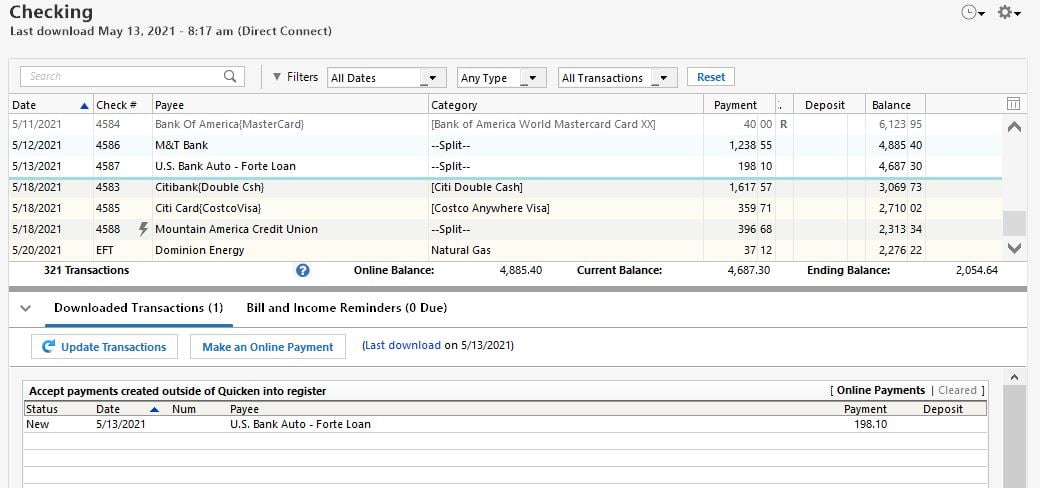

Boatnmaniac. Thanks for your lengthy post. This just started yesterday. I download my transactions daily. Unfortunately I can't provide you a screenshot because I corrected this morning's download. This unusual issue is as follows: I will download the transactions from the bank and a single transaction appears that matches a transaction in my register. The transaction in my register was from a scheduled transaction. The strange thing is, the downloaded transaction matches the register transaction except for lacking the check number. But, the downloaded transaction is shown as "new" and not "matched". If I accept the transaction, it is added to my register then the rest of the downloaded transactions from the bank suddenly appear. I simply delete the transaction downloaded/added to my register and mark the original transaction as reconciled.
When the transaction appeared I immediately went to my account at US Bank. The transaction was shown as Pending.
Something else is new. I am now experiencing crashes. I've never had those before. and Quicken seems unstable. A lot of flickering from the mouse pointer when first opened.
I did do a validation today with no errors.0 -

Thanks for the reply. I'm using Direct Connect and get the $3.95 charge monthly. I'm using Version R33.19 and Build 27.1.33.19. I ran the most recent Mondo Patch with no results. I ran an update this morning and made snipits of both my Quicken register and my US Bank account. You will see the downloaded transaction that says "new" yet it matches the transaction in the register. Also, in the US Bank account the same transaction shows pending. No idea what's going on here.0 -
Clearly in this case US Bank is sending pending transactions (their fault not Quicken's).
Then there is why isn't Quicken matching the transaction since the amount/date and even the payee match.
My guess would be the check number. As in the pending transaction downloaded doesn't have the check number, and the one in the register does, but even that seem strange.
As a test I would temporarily remove the check number from the one in the register and see if that gets it to match.

Thanks for the reply. I removed the check number and saved it. The uploaded transaction still didn't show "Match". The only fix is to Accept the transaction then Delete it. It clears the following day.0 -
